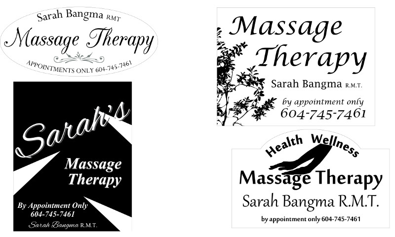

Here's a few versions of a sign for an RMT who works out of her house and wants to be sure her clients know they're at the right home. She is in a busy neighborhood, so I figured it is worth having her phone # so potential clients have a way of contacting her.
My preference would be to do the top left one as a sandblasted cedar sign with a nice routered edge so I can play with some new equipment. I'm not 100% happy with the fonts though and was thinking it would look good in A&S Old Glory for "Massage Therapy" but I don't want to buy the font if the design sucks or she doesn't like it. (I'm just starting out so my font budget is verrry limited right now)
The bottom left was inspired by a design on the A&S site, but I don't think it's her style at all so that one's more a design exercise for me I guess.
The ones on the right are based off her requests, and again I'd love to use better fonts like A&S Cardiak, Bogie, or Snapper Script. The top one is because as one of her requests she wanted to incorporate a tree, and the bottom right is me trying to make her initial sketch work.
Please critique away, I love learning from the amazing talented designers here (and hope one day to become at least a little bit like you).
-Always work off the customer's request and incorporate the tree. If you do not incorporate the customer's initial ideas in sign design you are telling them that they are unable to convey their business passion. If they agree to have you convey their passion and their business tanks, what are they gonna do? Blame that stupid sign that you created that did not reflect their passion.
I think the tree idea works for her business. It must be strong and convey shade and relaxation. A half silhouette of an old oak or maple on the left side reaching over the top of an oval sign would work.
Try to convince her to make her name- or better- just her last name the title on the sign. Massage Therapy as a title is too common. It should be the sub title. Remember- one word signs are strongest, two lines of text may be needed, three lines of text risks loss of interest and four or more lines of text may cause instant repulsion.
The script fonts are cool but they are very common for the "wellness" industry.
A script font would compliment and match an old shade tree graphic- use her personal signature of last name and make it legible.
An elongated sans serif font for sub title. - Stretched lettering conveys relaxation.
Just hope her signature is some what vertical to contrast the horizontal tree. Ha Ha.
Good Luck.

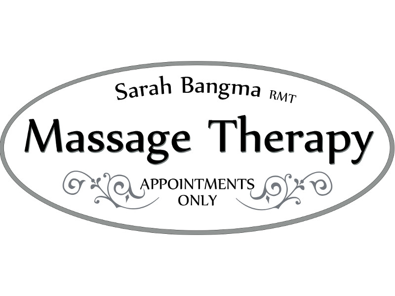

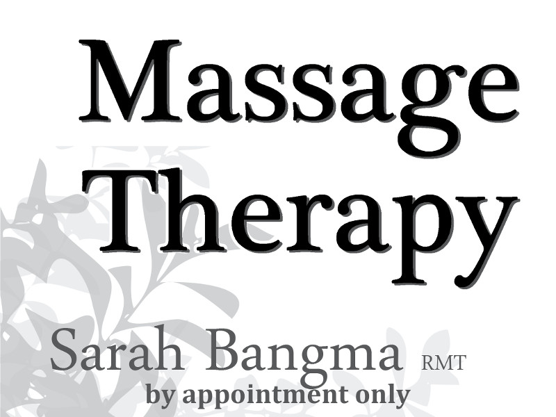

Wow, lot's of interesting discussion happened while I was gone. Finally heard back from my client and she's going with the oval design, so I'm
looking for some more feedback, please.
Sign is going to be sandblasted cedar. My first sign of this type, so any pointers on this will be greatly appreciated.
She really wants a tree, does this one work?
Also, how did I do with adding her phone #?
I want to show her both options imposed on the front of her house to scale so she can see for herself how the extra info doesn't help, but it is ultimately up to her.
Thanks again for all your time,
Amy

I like the one with the phone number but I would center the number to her name.
SignManiac
I prefer the left version without the phone number. Try and improve on the contrast between background and lettering.
What height and what stroke width are those letters ??
Are you blasting the background away or the copy ??
Do you have or know anyone that can blast this kinda sign ??
Are you going to buy a blank and hope the grains match ??
Can you make the proper mask for a sign this size ??
I'm only asking these things, because if you're proposing such a sign, can you really produce it ??
If you're next question is.... who can do this sign for me..... where are you gonna make any money ??
Marlene
without teh phone nubmer. Gino asked a bunch of good questions, how are you making this? you asked for tips about working with cedar so I can only assume you are making it and not having it subbed out to someone who know what they are doing?

Thanks for asking Gino. I am hoping/planning to do this myself (fingers crossed the "tuition fee" aka. screw up factor isn't too high) as I'd really like to add this type of sign to my skill set. I read several tutorials online and the whole process sounds relatively simple, but then it always does when an expert explains it so that's why I really appreciate all the input I'm getting here.
The sign will be 32" wide x 16.25" tall and I am planning to blast away the background. That makes the smallest letters approximately 1" tall with a stroke width of 0.17" Is that too fine/small?
My Father-in-Law has the equipment, I want to try it myself so picked up some extra cedar to practise with before working on the actual sign. My husband would be more than willing to help me with that part (he's a tool a-holic ;) if I can't get it.
I bought cedar and laminated it together to make the blank.
According to it's technical specs my plotter should be able to cut the mask, but I've lost faith in it a while ago (wish I'd found this site before buying it, but it's what I have for now so live and learn I guess) so if it craps out I could try hand cutting the mask but I'd really prefer not to go there as that sounds like a lot more time/work.
At that size for letters and the thinness of them, you’re probably going to blast most of it away from underneath. Even staying at a perfect 90º, you’re bound to blast underneath and annihilate portions.
If you glued it up yourself, did you biscuit or do anything to reinforce your seams ??
Hopefully you used a really good wood glue for exterior use. Remember, after you blast away, the glued areas will be exposed. We use a two-part boat glue. The seams actually seem stronger than the wood itself after drying in clamps for 48 hours.
Good luck !!
