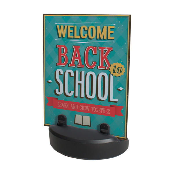

check out Grimco for a mounting base. it's a heavy round thing that you can put a post into and attach any size sign to it. they also have some that have a little kick whell so they can move it around

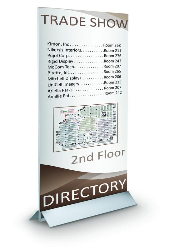

attachment.php

I should mention, that if its only 3mm composite you are going to need to add some sort of stiffener to the back to keep it from being floppy,Assuming its single sided, If its a double sided sign you might want to just print a single sided panel and tape it to the back of the existing 3mm giving you a 6mm panel and much more rigidity. i hope that came out right
