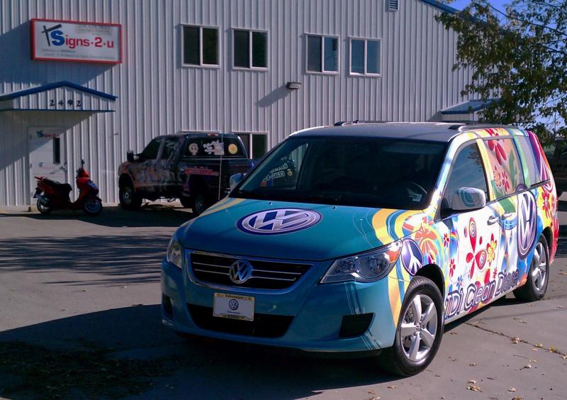

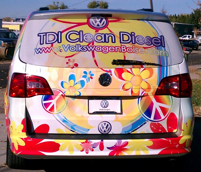

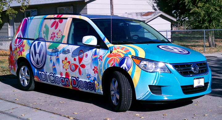

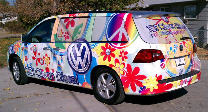

Signs2u
VW Routan Wrap - pictures and info
Printed on 3M 180cV3 w/ 3M 8519 Luster Overlam. Clear Focus on the windows.
10 hour total install - please note that there are NO seams anywhere on the vehicle and also no overlays to match up the flowers, etc.
Designed, printed and installed in house.
grafixemporium

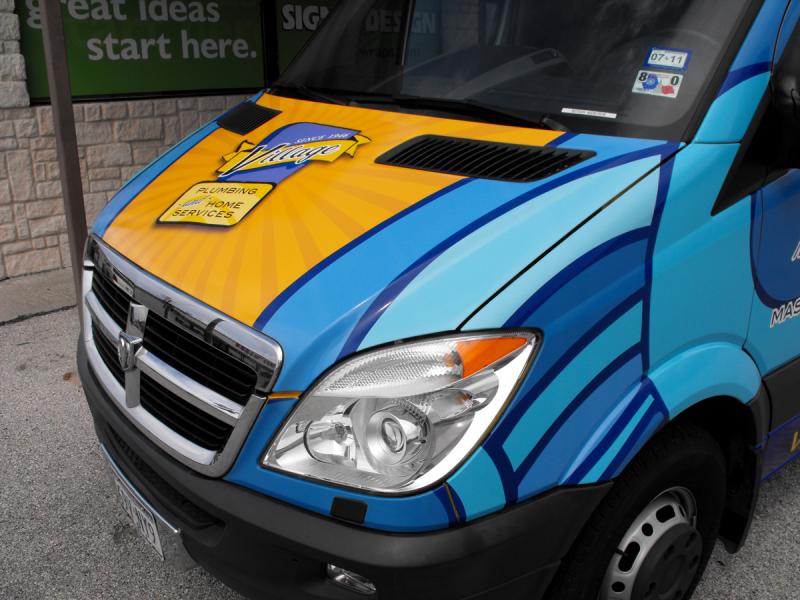

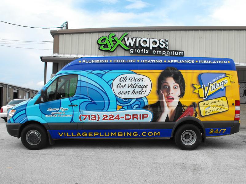

It's a nice job, but I wouldn't point out that you didn't do overlays. That just draws attention to the fact that the hood and fenders don't line up. There is no easy way to do that. We usually design our way out of issues like that. If I really want to impress a customer and have to do something of this nature, I'll wait until the sides are installed then draw a template for the hood to ensure the designs line up perfectly. In this case, I think a small overlay on the hood would have looked better than not matching up. Wrap the hood in blue then overlay that fender panel and trim using the edge of the circle as your seam. Then it would have looked like you are an installation genius and no seam would have been visible at all.
That's exactly how we did these...

Signs2u
Considering we did the entire thing in one print, including the window perforation the passenger side of the hood being off by a slight margin became acceptable.
Anyone can cheat and waste two days by printing later.
Signs2u
Besides, look at the back of that wrap - the panel goes all the way from under the tail lights, behind the rear tire, to the other side. Lines up perfectly with everything. Winning.
Signs2u
"If I really want to impress a customer and have to do something of this nature, I'll wait until the sides are installed then draw a template for the hood to ensure the designs line up perfectly." - GFX
This means that you have a customers vehicle for 2 extra days - we print and let everything vent before laminating.

grafixemporium
Reread my post. I said IN THIS CASE I think overlays would have looked much better and you could have easily hidden the seam on the edge of the circle. It takes no extra time at all to do the job the right way.
The only time I would consider going the template route is if it was a project that had to be perfect and seamless. That means $$$. So it's pretty rare we go to that extent. Typically overlays work just fine for stuff like this and when they are done right, most people will never even know they are overlays.

Signs2u
I should note that the customer was absolute about there being no seams anywhere on the wrap - no question. We are going to be wrapping a few more vehicles for them and I think I will sneak in a new hood at some point to replace this one. That all being said for building this off of a template we made in house and having it print that close on the first try is really impressive - anyone who has attempted to do this understands.
