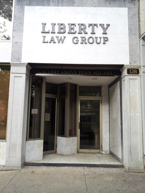

Just did a job this morning of 12" & 8" Gemini Minnesota letters and we were not allowed to stud mount, so after checking with my guy, got something called MS35. This stuff sets up in like a minute. It's tremendous and it's use is for almost anything.
We taped a plastic grooved strip for each line with the spacing predetermined for the letters. Put the schmutz on the pads, pressed it in place and held it there for like 30 seconds and went to the next letter. Til I got three letters down, they were 100% in place and holding perfect. No taping was needed.
Washing the wall first with soap and water and then alcohol, making our grid lines and taping guides in place, then putting the schmutz on setting them in place and removing the guides and then mounting the 8" x 96" sign for the gallery in solid steel took us from the time we got there until we left, less than 1-1/2 hours.
We even used the MS35 on the back of the gallery sign to hold it in place and then drilled 3 screws in for a little extra measure. It held that sign in place without the physical fasteners, but we just wanted to play it safe.
