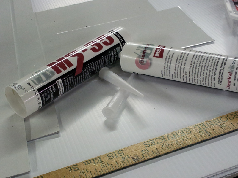

HUGE fan of silicone. BUT, only when you can allow for the bead thickness to be 1/8" or more. Which is why I will always preach the vhb tape and silicone combo.
try applying a
sign panel with silicone-only or silicone/thin bonding tape combo and comparing to silicone+vhb. ...a million times stronger.
