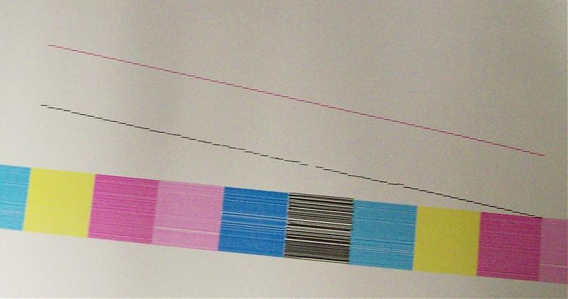

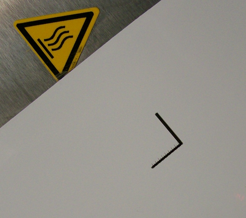

I have notices small consistant streaks in the black printing on my mutoh falcon outdoor 6 color machine. I have included pics of the nozzle check and a close up of a registration mark. I have broken down the machine and cleaned the heds and even looked at them super close, and there are no hairs and or dust on them, and i still get this consistantly. Any help would be greatly appreciated. Also, when i hit shift and the key to print the test print, it does nothing....like it isnt in the memory anymore......

oh by the way i have also done many powerfl head cleanings and printed about 75 feet by 4feet worth of print since i noticed this, and it has not improved or gotten worse.

What is your black set at? Meaning maybe the file your printing is too much ink. Also check and see what your black is set at in file , It should be 30c30m100k, That should give you a nice dense black and will eliminate your problem. If you very much from that black formula you will get what you have in pic.
MacDaddy
Clean Clean Clean
Clean the Encoder Strip with a lint free cloth... Your Nozzle Check has some issues in the Black... Make sure you put the head in the 'low' position when performin the powerful cleaning... Check the 'wiper' and make sure it is clean... It looks to me like you may have some miss=directed nozzles... Clean Clean Clean...
Jackpine
Clean around the print heads with a foam swab and cleaning solution. You may have a "fuzz" on the edges or the print head. Clean the wiper or better yet replace it. They are cheap and wear out.

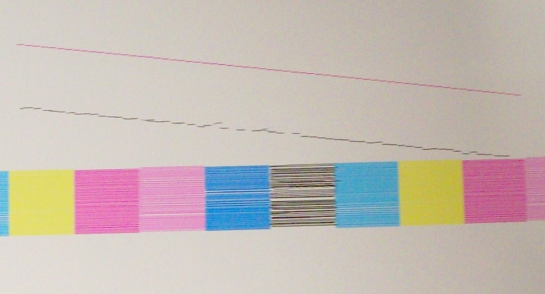

I have cleaned the heads with a swab and the bottum of them looks like new, here is a better shot of what the black is doing. Thanks all for the reply's and i hope we can get this resolved!

These look like primarily, deflected nozzles.
Either from damage, or more likely dried ink near the edge of the nozzles themselves.
Take some clean room wipes (non-shedding) fold them over, wet them with cleaning solution, lower the capping station and move the carriage out, place the wet wipes over the caps, mover the carriage over the caps covered with the wet wipes and raise the capping station so that the bottom of the heads makes contact with wet wipes.
Rewet the wipes every 15 minutes for an hour or two and immediately do a strong clean or two and nozzles check again.
The idea is to get enough cleaning solvent on the 'dried ink' around the nozzles to soften it up and get it removed.
Do make sure you have good clean wipers.
A dirty wiper will just smear all that dirt across the bottom of the head an into the nozzles.
Normally, the wiper is the ONLY thing that should contact the bottom of the head, so use caution. (i.e. you probably want to power down the machine for soaking).
