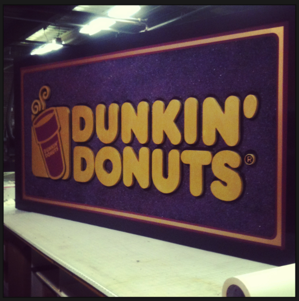

that purple sign with the swirls is cool.
I haven't bought any in years as I bought big bags of it and enough Smiths Cream to last a life time but I got mine from Esoteric Sign Supply. I'm not sure if they are still in business as I think the owner passed away years ago
Marlene
you need to post some better pixs as that looks awesome! the background smalt looks to be purple, is that the color? it came out looking great
Billct2
Nice, smalts looks like it came out great. Thanks for the follow up.
(one critique, the logo is too low, should have more space below than above)
