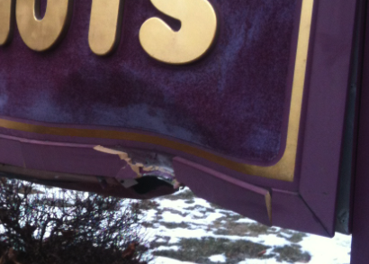

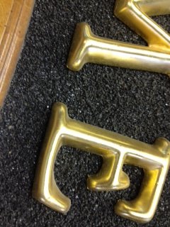

If I'm seeing that pic right that is a really bad smalt job, is it glass smalt? Looks like sand. When smalt is properly applied you should see very little background showing through, if any. So the idea for coloring the glue is to match the smalt.

Your pic does not look like smalts. Looks more like sandblasted hdu
The sign s a series 7 flush mount extrusion kit with aluminum faces, painted, with smalts, and pin mounted letters.. they put some HDU trim on to hide the hardware that attaches the faces.
What you see in the pic is the edges of some hdu gold painted letters in the smalts area, the gold border, and the HDU trim. painted..
The lighter areas of the smalts is where it has failed.
We won the bid to replace the whole sign due to someone ramming it for whatever reason..
