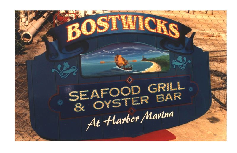

Here you go Pat. A $1,500 4'x8' painted sign on MDO done twenty years ago. Back when everyone said it was impossible to get more than $200 for a plywood sign. All hand lettered, airbrushed and hand spun 23k gold leaf. Totally flat sign done with 1-Shot lettering enamel.
A couple of weeks of practice and you should be able to knock one of these out in no time. Enjoy the brush and most of all, have fun!
