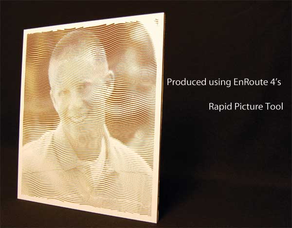

Hey guys - I noticed you mentioned EnRoute a few times, so I wanted to give a bit more information. It sounds like EnRoute's new Rapid Texture feature is exactly what you're looking for. I've attached a picture sample of how the Rapid Texture feature works. You can also check out some video demos here:
http://www.enroutetv.com/

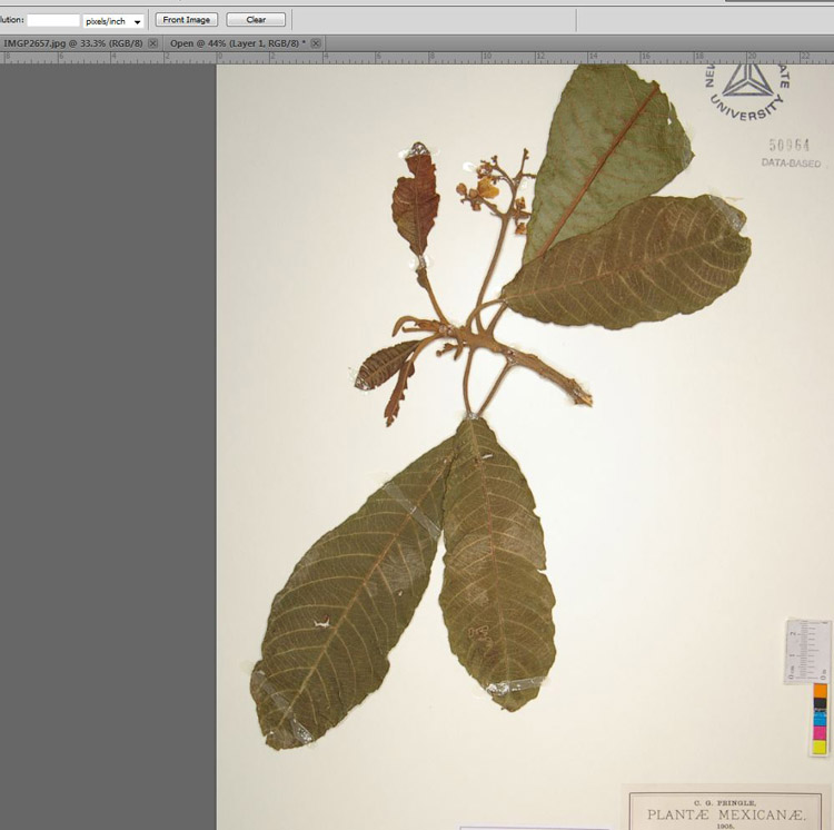

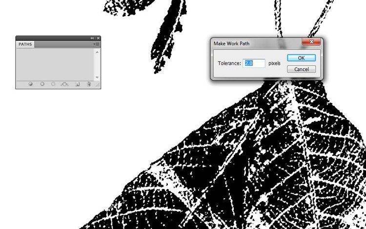

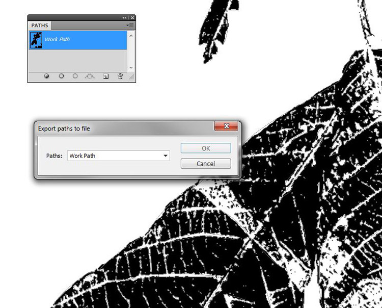

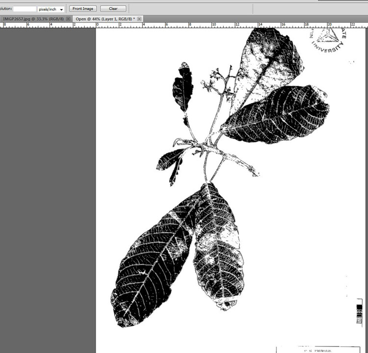

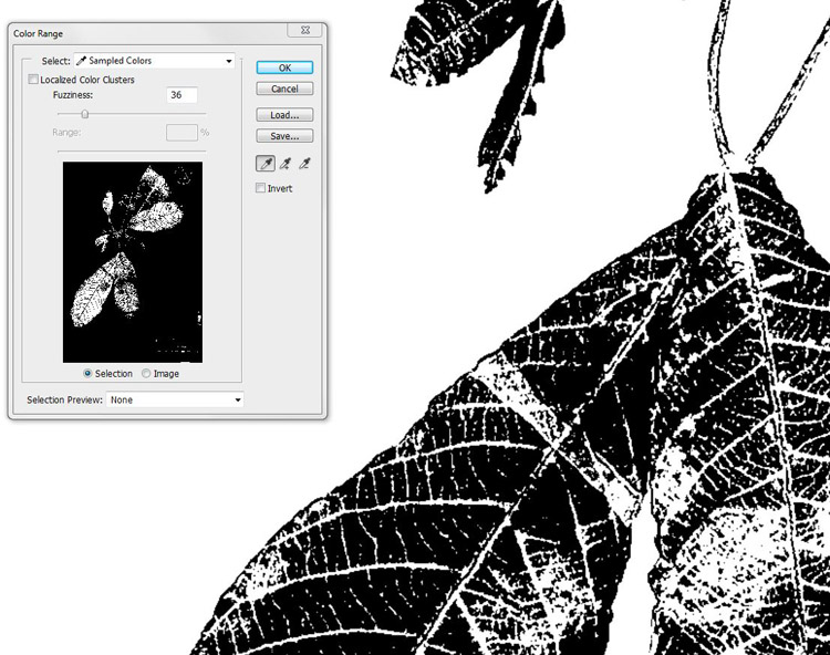

as for line art, this is my favorite way to get good closed lines out of a bitmap (the bit map was completely untouched when i started. photoshop does a good job of picking up detail.
threshold
color range
paths (make work path)
export work path to illustrator
import to corel (make black)
export to dxf
