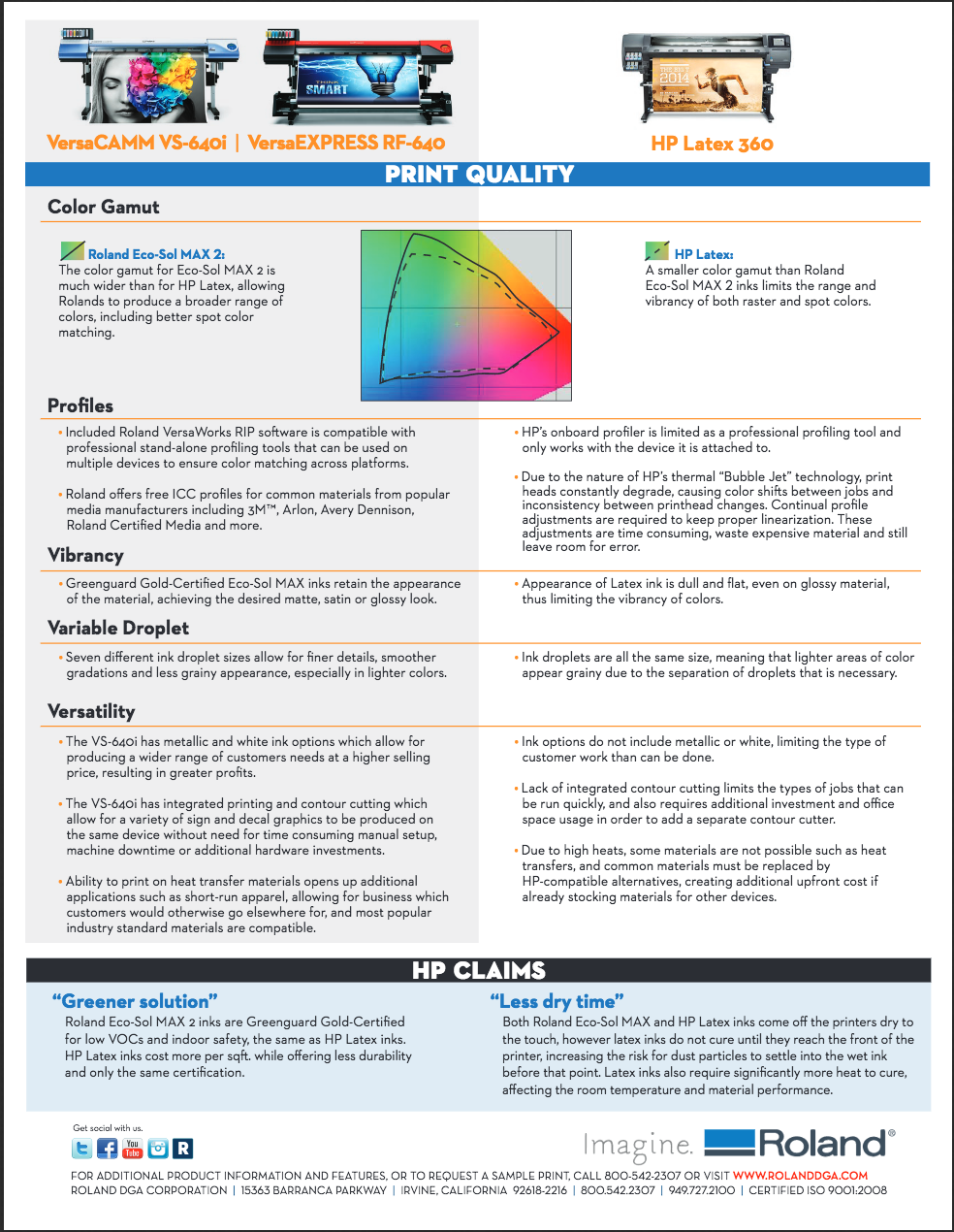

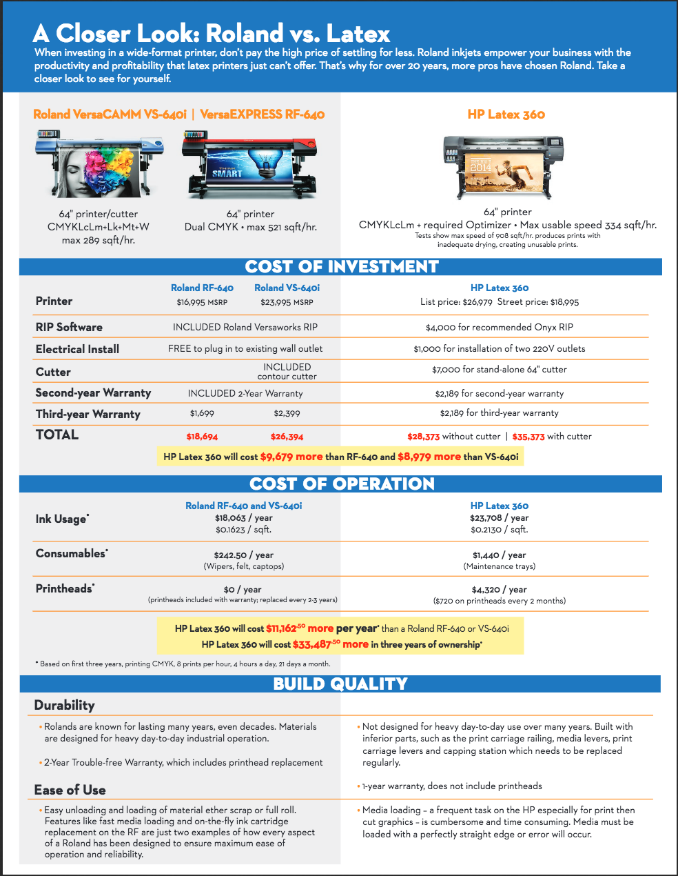

Not knocking HP here, they have a good concept and its a work in progress, and maybe one day all the stars will align for them, and when they do, I will have to consider LATEX again, but for now, I am not SOLD with the experiences I have had with them, and as stated, I have installed hundreds of LATEX units over years starting with the L25500, to the L570's. If you want a solid Tried and True printer, I would suggest a EPSON, MIMAKI, or a ROLAND printer. The comparison chart below is really for any Solvent Printer, but all things to consider before making the investment.
