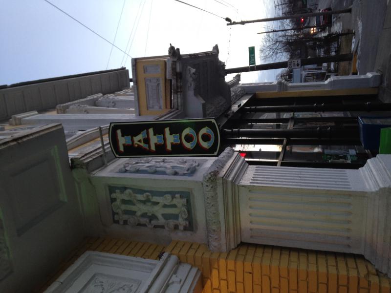

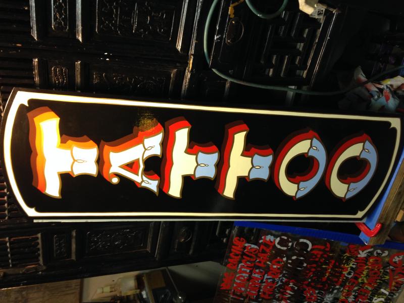

Wow thanks for all the wisdom everybody! Didn't expect all that, but I will now be preparing my MDO accordingly, and picking up some bulletin enamel.. I just got finished installing the job that really had me wondering about all this- it's a Rusto Pro background coat lettered with 1shot and Ronan, hope she holds.. I kind of alluded to my concerns with the tattoo shop owner to which he replied his sign will just "look cooler faster" so live and learn.. I don't know why these photos are sideways but you get the idea.

Billct2
Nice looking sign. A nice bracket would really set it off, you should look into some of the suppliers that carry the better ones (like hooks & lattice)
