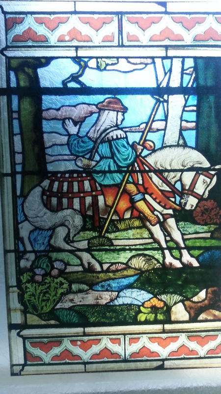

double print on Oracal 3620 transparent mat
applied on a textured glass (from a stained glass supplies store)

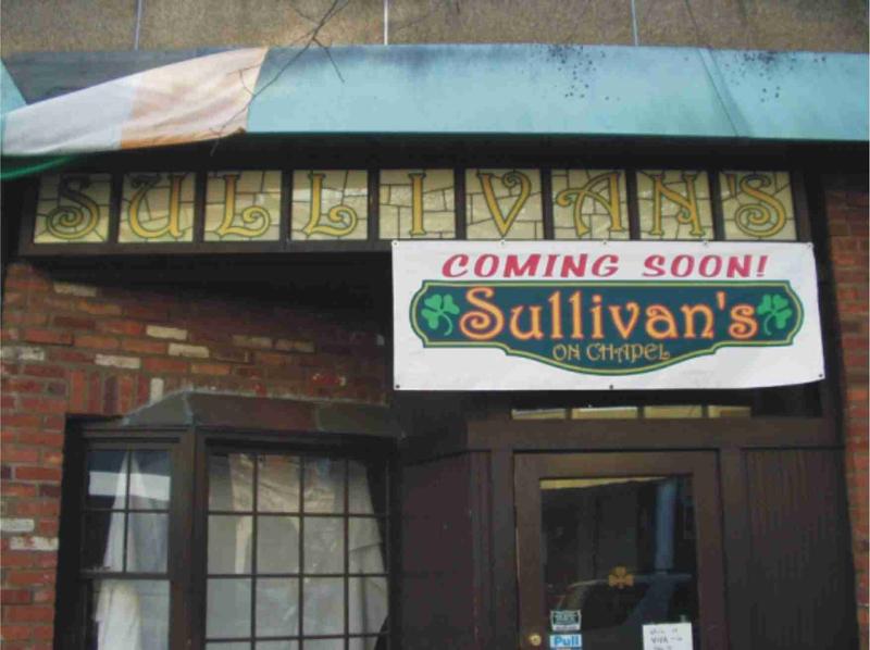

I've did it for backlit panels. First I did an electric sign face with a stained glass look (see pic). Then I reproduced a bar back panel that was real stained glass (don't have a pic of that). But they were backlit, so it's a different look. To get a stained glass look on regular window I would try transparent vinyl (not translucent). I used duranodic vinyl for the "leading".
