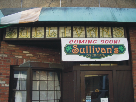

I did this fake stained glass for this pub. I also did some replica stained glass for inside that was much more detailed (and also backlit). I created custom fills in corel (if I didn't have to match the existing glas I would have used one of Fred's fills) then printed them on clear and applied to beige plexi. They were hard to tell from the real ones. I'll se if I can find a pic of those.
I like that, those letters look like the real deal. What did the beige plexi do that you could not do by printing?

Billct2
The beige toned down the illumination giving it a softer older look.

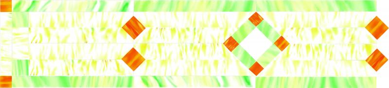

Here is a fill I built to match the existing glass inside . I put duranodic vinyl stripes on
for the leading after printing. Wish I could find a pic of the finished job, it looked pretty good.

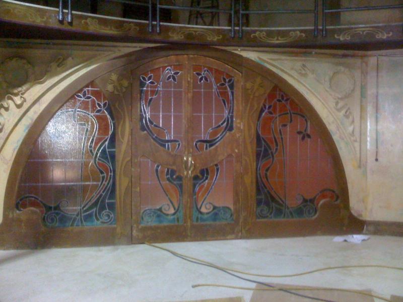

We do stained glass for the film industry all the time. The file is usually created in photo shop with the "led" included and some modelling in the colored areas. I print double pass on clear. Stick the vinyl to glass or plexi. Than we use real led tape to cover up the led lines. We than use a two-part clear resin to cover up the graphic. We mess around with the resin so that it dries with some texture to it. It's a long process but it always looks great.
This photo is from a set on Smallville.
