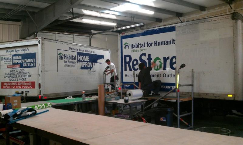

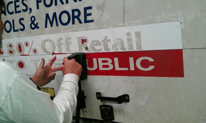

HulkSmash
How'd it go Adam?
This thing.... works wonders. Took us 2 hrs to remove a 17ft by 8 inch stripe by hand with a torch. We did a whole truck in 2 hrs after that. The best 50 bucks ive ever spent in my entire life. Got 2 of them... i can't exaggerated how helpful the wall paper steamer has been. It's just like... every shop should have like 5 of these things... so...amazing....
here's a pic of them removing it with it. There's 2 fixtures you can use. Right now they';re using the smaller one because it heats a bit faster, but there's a bigger fixture that is about 18x10 inches that works well too.
so yes, it works. thanks everyone for the suggestions. Oh, and it didn't leave any adhesive behind..
