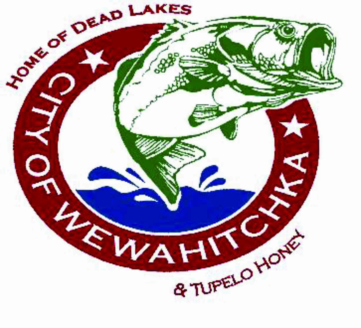

A customer wants to paint graphics on a concrete water tank with stencils. The tank has been coated fairly rough and top-coated with latex paint. At first I thought maybe high-tac sandblast stencil but now I'm not sure. Does anyone have any suggestions? Thanks

I asked and they have used pounce patterns before, but the surface is too grainy to get a good transfer due to the detail of the graphic. Do you think Gerbermask Ultra 2 would work on this?
How big is the final piece on the tank ?? Also, using copperplate is almost a joke, if you don't think you can pounce it.
I pounced and painted a stucco wall about 3 years ago. Turned out fine. Not near the detail you have, but it can be done and I was about 25' in the air going about 55'

If it's too rough to pounce no way will paint mask work. You are then into skilled wall dog work using scaled sketches and a grid.

Customer says the round band part is 5' high. Pretty small for a water tower I would think. I'm thinking most of that smaller detail could be eliminated.

With something as detailed as what you showed, they might be better off getting a mural painter to do it.

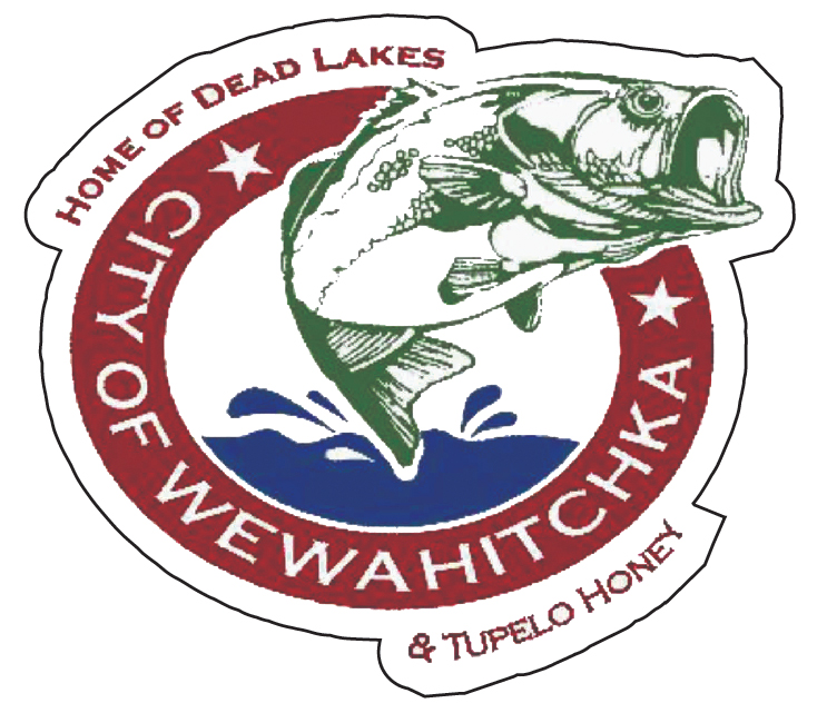

Print it with a flatbed, vinyl or whatever..... even hand-paint it on a piece of 3mm ACM and put that piece on the tank. Done and all the detail is in tact. I just did a quickie, you'd make it smooth edges and nice. This was just for illustration purposes.

Yep, at 5" I would think a vinyl graphic on acm with some back cutting if a rounded surface and you could mount it to concrete. 5' is pretty small for a tower plus that high up.

Print it with a flatbed, vinyl or whatever..... even hand-paint it on a piece of 3mm ACM and put that piece on the tank. Done and all the detail is in tact. I just did a quickie, you'd make it smooth edges and nice. This was just for illustration purposes. View attachment 134927
Please excuse my ignorance; what is "ACM"? Just a sheet of 3M controltac or something?
