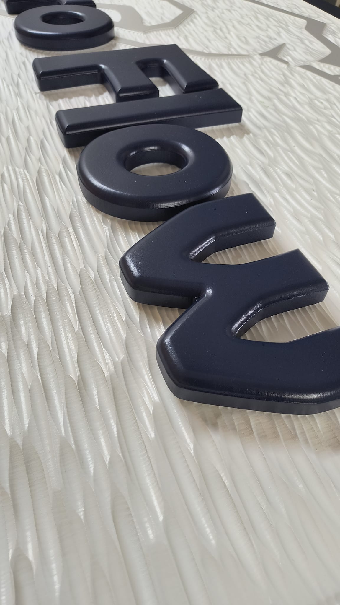

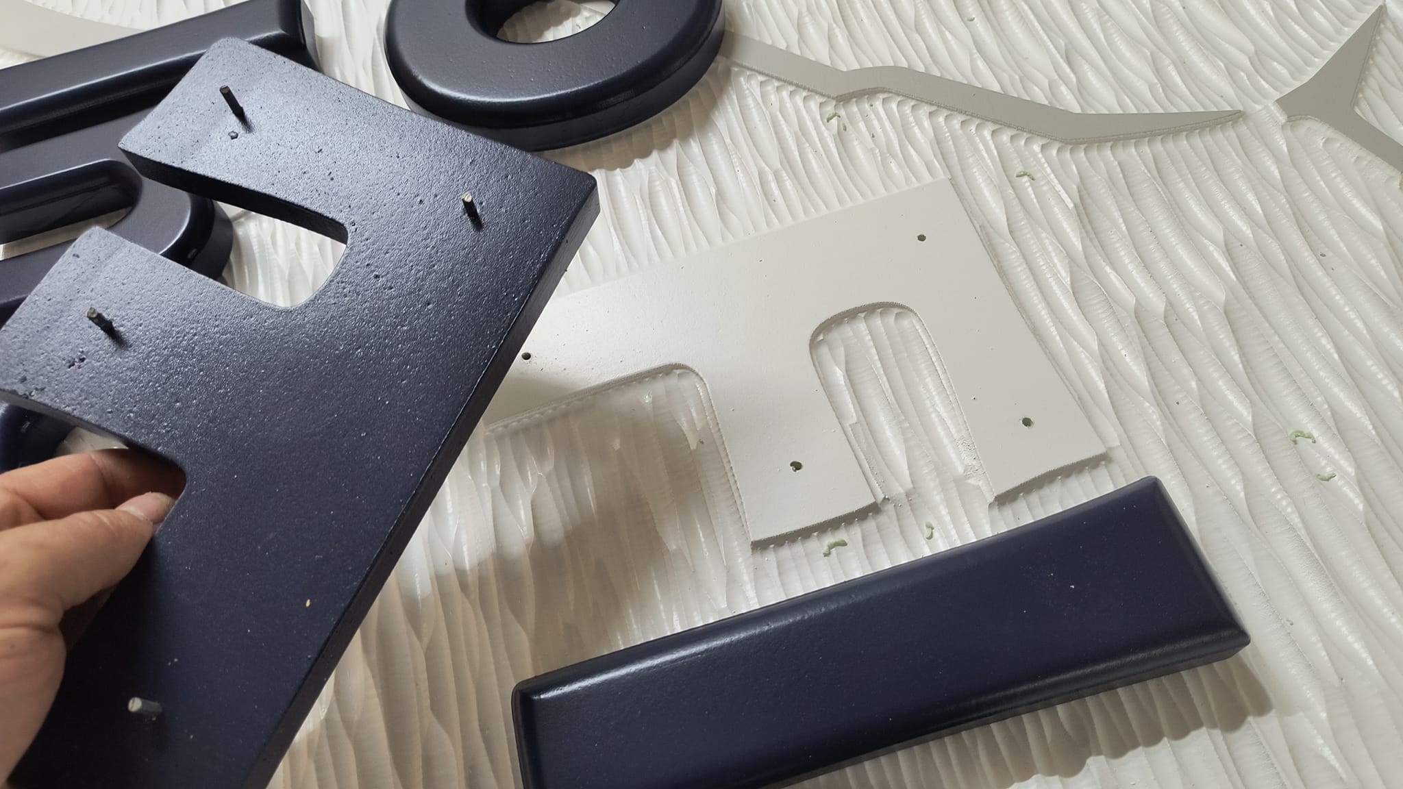

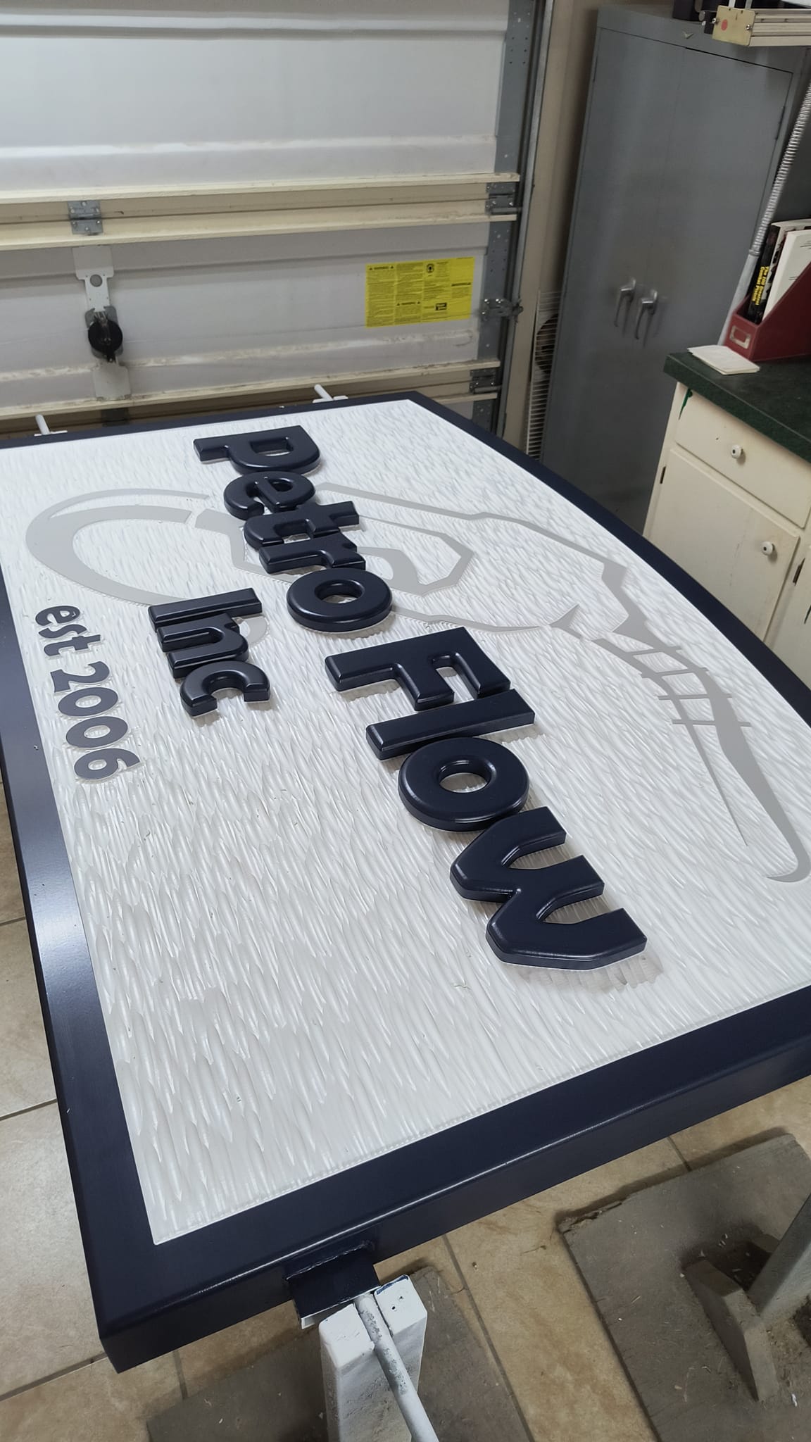

No, not them kind of stick on letters. I drilled holes in the main panel and the backs of these HDU letters with a 1/8'' bit on the CNC, then cut the studs out of some 1/4'' pop rivets, They were a very snug fit so the letters are aligned perfectly. I sprayed Sherwyn Williams Industrial acrylic on the letters and panel. Now I want to glue them on. Would you use gorilla glue? I thought about silicone but would GG hold better and last longer? Thanks

It does look nice. Beautiful work there.

Are these steel rivets? Next time, just buy some threaded studs. You get a whole lot more grip with threads, you can order Westrim 2"x3/16" studs from tons of distributors, precut, and aluminum for corrosion resistance.

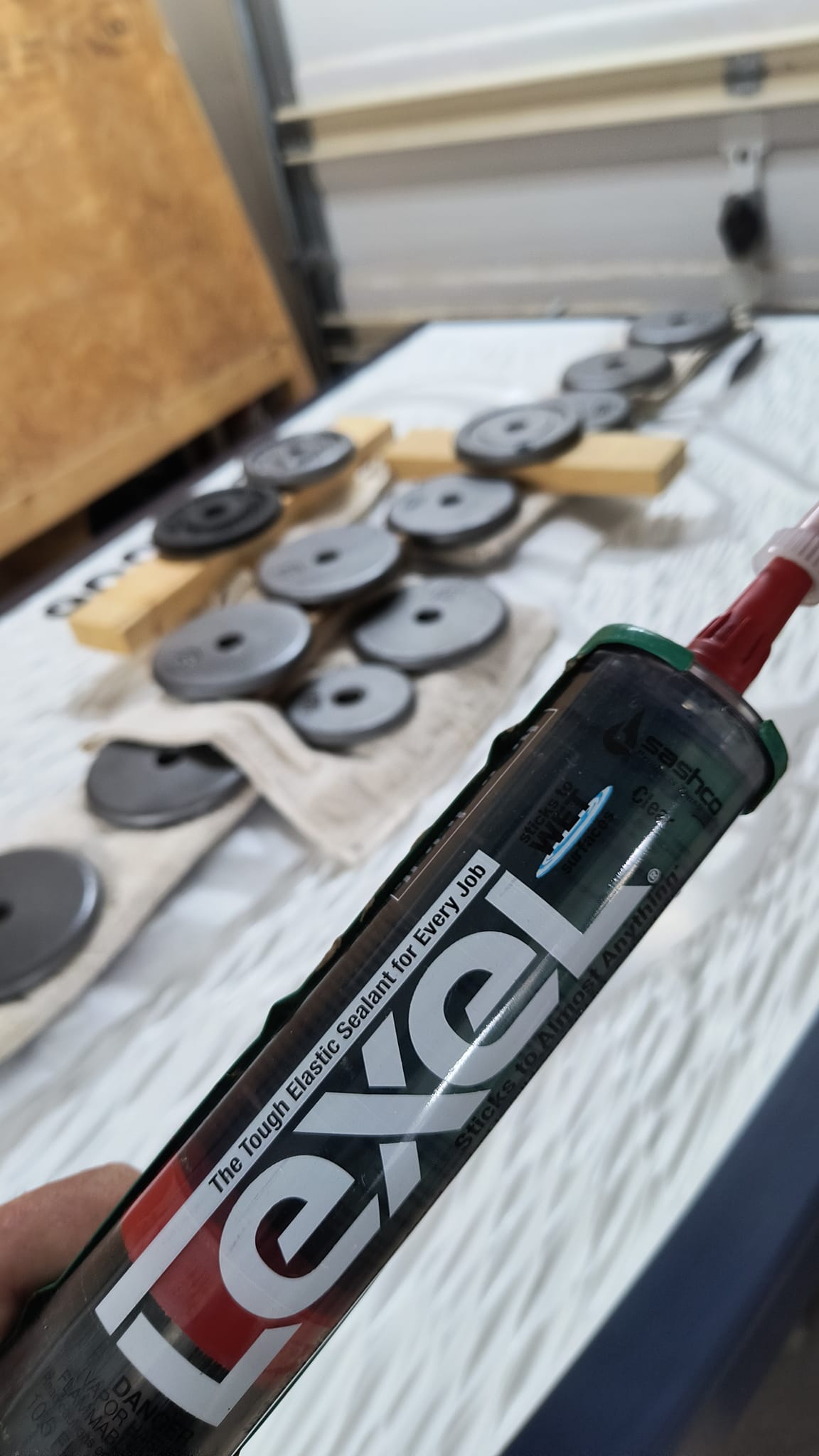

Ok, I did it with some Lexel. I figured GG would do fine but, the thought of that stuff expanding out from the sides was gripping my heart with fear.

Ok, I see the warning about steel rivets. Too late. I do have a bunch of the threaded studs left over from Gemini letter jobs. I'll do the other side with those. Dang.

Ok, that makes sense. What about my stupid mistake on the rivets. I could just about cry. They said "aluminum" on the box, but I checked one of the stems with a magnet and they're steel. I used a double row of adhesive on all the letters except the "I's" and the smaller "Inc" at the bottom. So the rivets are enclosed by adhesive on most of the letters. But am I going to have a problem of them rusting and streaking this sign sooner or later? I tried pulling up a couple of letters bet they are stuck fast. That stuff works quick.
