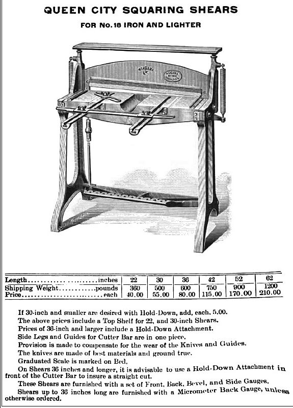

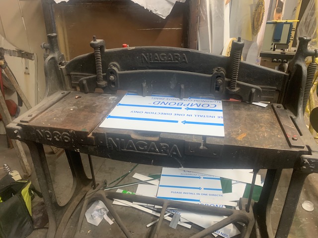

Shear is an important tool. Get a good one. I've had this Niagra 1911 model for 35 years. Still cuts nice. Bought at yard sale for $10. 4 men and a pickup truck to transport.
Moving a niagra is an experience.
It will probably outlive you, however
