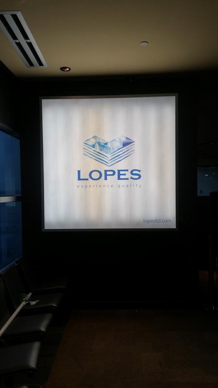

Can anyone suggest might be the cause and solution to the streaky lighting on this backlit box?
The cabinet itself is 6" deep and came empty. We installed the guts, including the fluorescent bulbs you can clearly see.
The graphic is printed 15oz flex face material.

First of all, not all your lamps are alike in there. You have some cool and day light mixed up.
The lamps are too close to the face. That's commonly called 'Hot Spots'. The back of the face should be at least 4" or more from the most outer portion of the lamp. The more you go, the better the lighting becomes because of reflection. In a 6" can, you should have them about an inch away from the back wall.

Simple as that eh? just too close to the face?

A pan face would probably make a big difference.
I think they make a diffuser film you could suspend between the light and face to spread the light.

Those are hotspots. Due to the cabinet not having enough depth. I believe you can put a diffuser on the back side of the acrylic..but you're using flexface.. not sure what you can do to help this besides make the cabinet depth wider.. ive always tried to stick between 8-12" deep when using florescent lamps. You can get away with 6" cabinet/can when using LED lighting

Lamp spacing 101
lamps have to b at least 4.5" from the face
spacing between lamps........double the distance between the face and the lamp.
