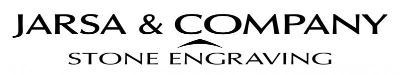

Well, I have to admit I'm un-educated when it comes to vinyl since we do mostly sandblasting (stone). Heavy monument stencil material is our medium of choice for the majority of our work.
It's time to letter the new (white) shop truck and I was thinking it would look good with black reflective vinyl. Our logo is artistic text only with a small geometric shape (triangle).
Wensco is my supplier of choice, and they offer FDC 2407/2457 series, and 3M Scotchlite Premium 680 series. The 3M is $60 more per roll than the FDC, but I'm looking for durability and longevity and am willing to pay a little extra if it's really worth it.
Any input and advice would be appreciated.
Jim

We've had customers use the Avery Black reflective before. I've heard no complaints. I think your logo would look just fine on black reflective.

We use mostly 3M, but also like the Oracal 5600 series.
It's your own truck, so if it fails a year earlier on ya, you can always do it again.
Food for thought........ Reflective vinyls need a little extra beef to them to keep them firmly planted on your truck. It's a thicker material [6 - 7 mils] and needs it in those wispy little letters. You might want to think about thickening up your second line of copy so it doesn't let loose prematurely regardless of which brand you use.
Thanks for the input Gino....will do.

Or you could layer an outline of regular black HP vynull underneath, which would beef up the letters and also aid in removal at a later time.

You also need to know that most black reflects a sort of off white color when light hits it. This includes the sun . In the daytime or at night if the sun or lights hits your truck at the right angle your lettering will disappear on a white truck. I prefer to use nikkalite on white because it reflects gold . I also suggest that you take jillbeans advice as reflective is a pain to remove.

Correct me if I'm wrong? But isn't black reflective about as useful as black translucent. I thought the idea behind black was that it doesn't allow light to pass through and doesn't reflect light. If it does, it is no longer black. I would put your lettering in standard black vinyl, and outline it it white reflective.

Translucent black is not actually translucent, but at least it's still black and performs it's job exactly like you would think.
Reflective black on the other hand, reflects light grey, making it unsuitable for many jobs because of the obvious contrast issues that would arise.
I learned this lesson well when a customer ordered a refl. black background with refl. white copy. The sign was completely illegible at night when hit with headlights.
The most common use of this vinyl that I see is for stripes on fire/rescue vehicles.

I thought all black reflective vinyl lights up white (or grey) at night. If the truck is white and the letters are reflecting white, what purpose does that serve. How often are you really driving around at night. I say save the money and just use regular vinyl.
