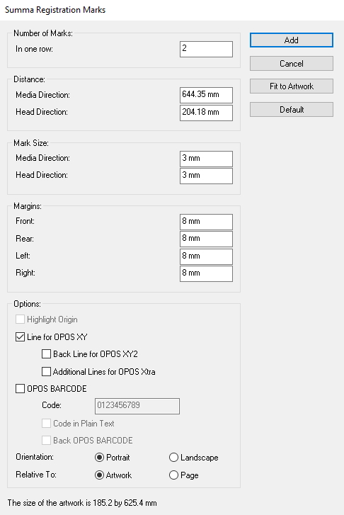

You can install MacSign Plugins for macOS, it will add a new command in the Object menu to add OPOS registration marks: "MacSign is a collection of plug-ins for Adobe Illustrator that allow you to output jobs directly from Illustrator to a Summa roll cutter for macOS."
You can download it directly from Summa support web site:
The plugin is updated to AI 2021 but it runs under rosetta with the new Apple Silicon M1

SIGraphics refers to MacSign Plug-in, a series of plugins for Adobe Illustrator for Mac that allows you to add Summa registration marks to graphics and send kiss-cut and Flexcut data directly to the plotter from Illustrator.
For owners of the MacSign Full application it is possible to add custom marks and add barcode (front and back) as shown in this picture:

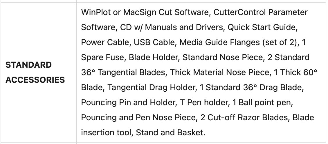

Thank you! Starting to get it. In my case....I design in the splendid comfort of my man cave in the basement on a Mac, then carry a flashdrive 56 paces in 16" of snow to my shop where a windows machine resides to run my printers and cutters.
Would I be correct in believing MacSign only works on a Mac?
It appears one of two programs come standard with a purchase: Winplot OR MacSign. Hmmmmm?
MacSign Plug-in only works on Mac, MacSign, the application that runs stand-alone, is for Mac (until 10.14) and Windows
Currently the software provided by Summa for its plotters (SOne, S2 and SummaCut, with latest firmare) is GoSign (Windows) and MacSign-Plugin (MacOs).
Winplot (Windows) and MacSign Cut (MacOS) are for legacy vinyl cutters only
