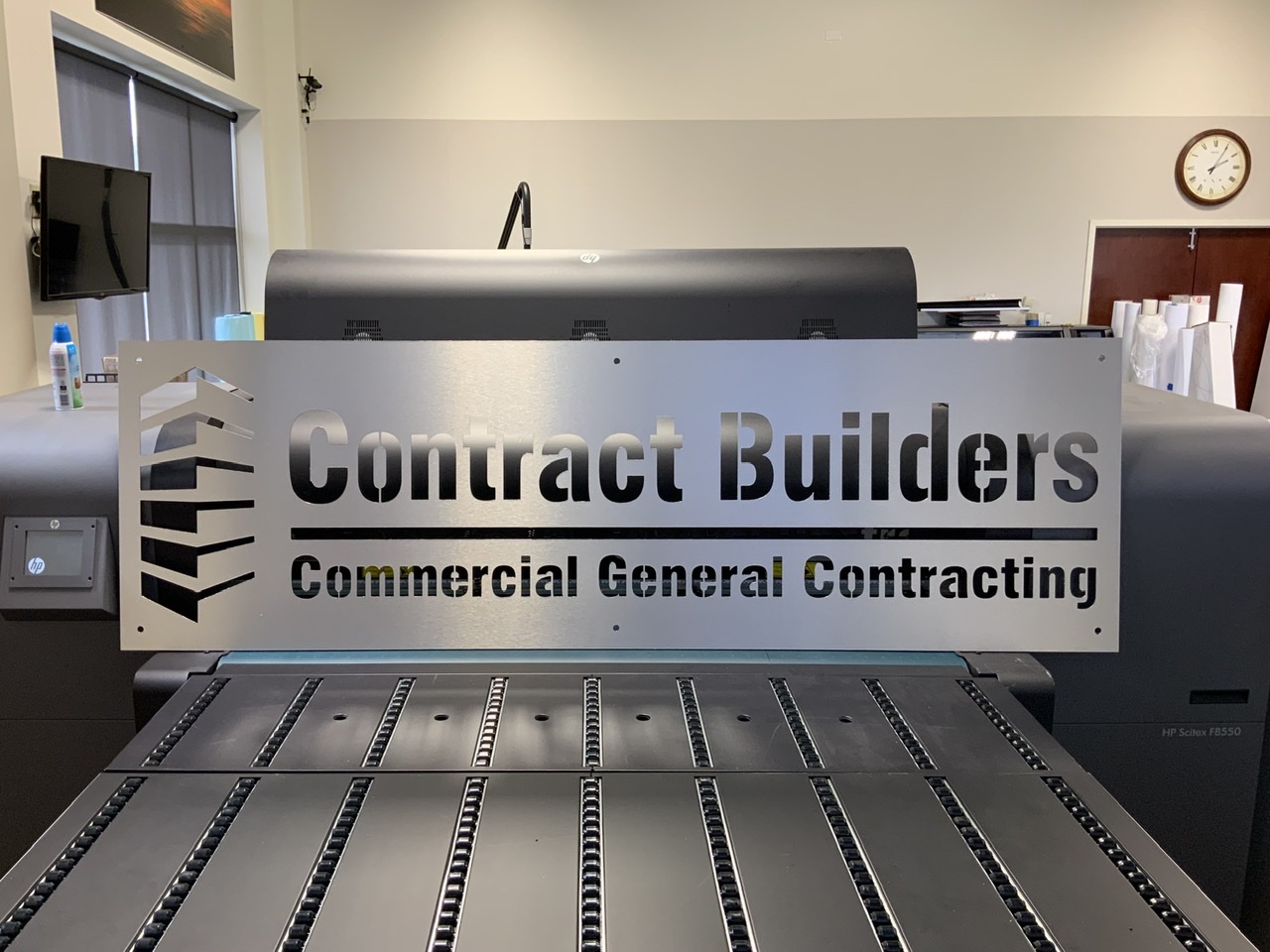

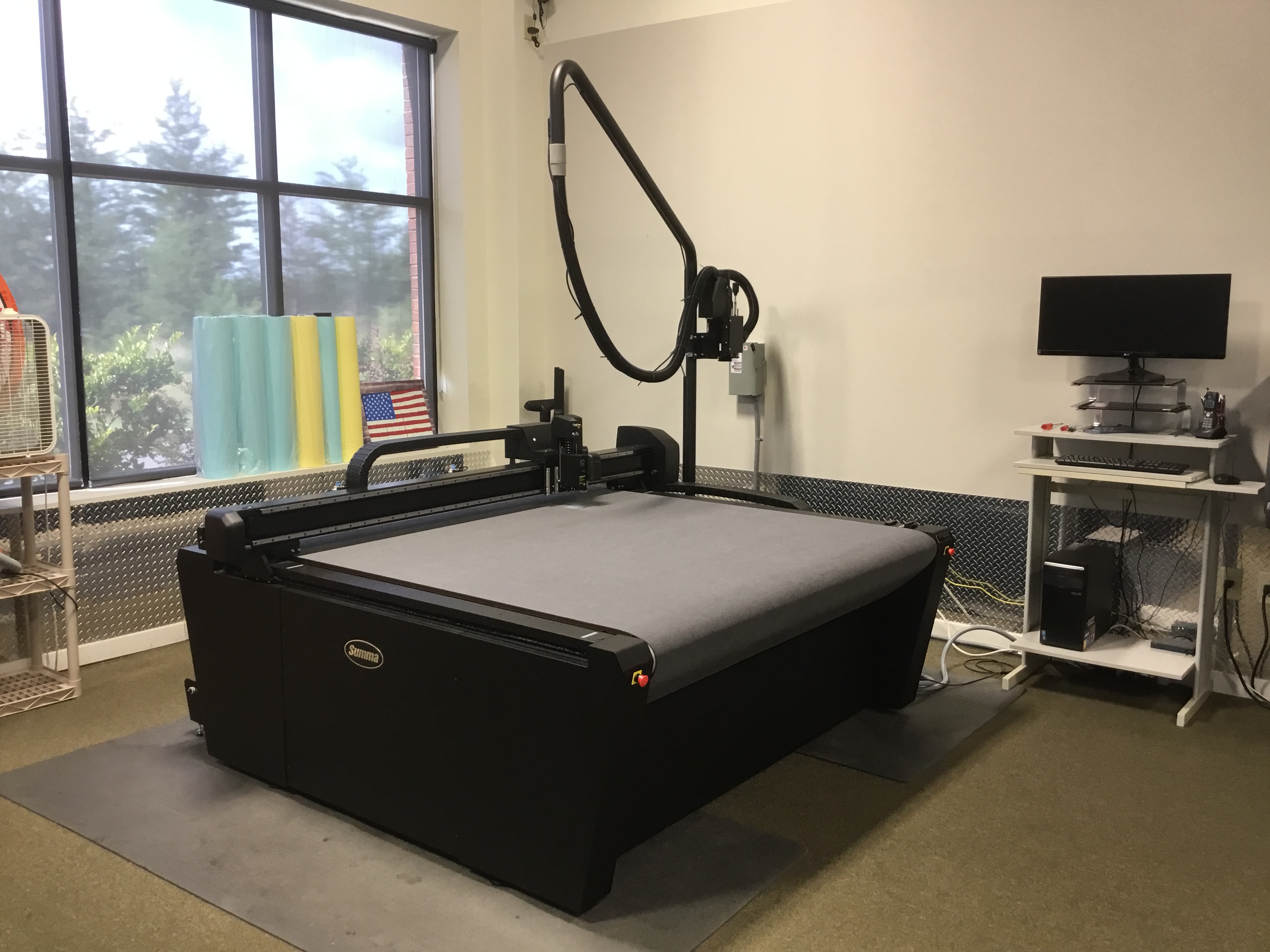

I love my F1612, I’ve had it about 7-8 months but couldn’t live without in now.

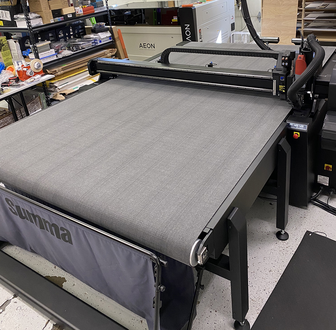

So with the extension table, you end up with an 8' long bed? Do you have pics of the set up? Do you mind sharing roughly what that cost, I'm assuming it has be installed by a tech on site? Thanks!

Technically, no. You have a belt that is about twice as long, but your cut area is still the same. I know when I first saw it, I thought it was dumb and didn't see how it would help. But after a while decided to go for it. I think it was around $4k. Like I said, it makes loading/unloading all materials way easier, especially boards!!

Just wanted to clarify that the conveyor extension adds 47" to the length, but the extension area is not part of the working area meaning you can't cut on the extended portion of the belt. It definitely helps with media loading and unloading like Matt mentioned. Retail on the conveyor extension, at least here in the US, is $6,490. Occasionally there are discounts/rebates available to reduce that cost. Sometimes after shows you can get a "demo" version of the conveyor extension to keep the cost down.

Sweet, thanks Matt! Definitely looks like it would come in handy if you've got the floor space.
