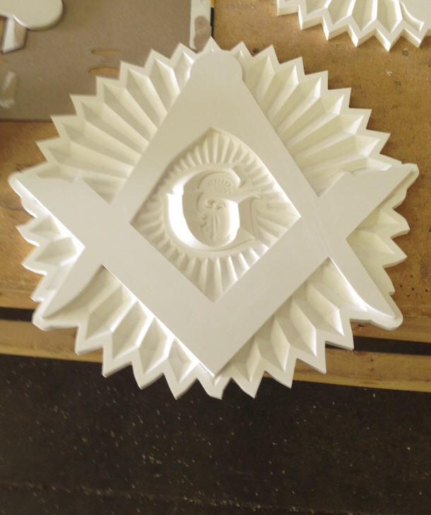

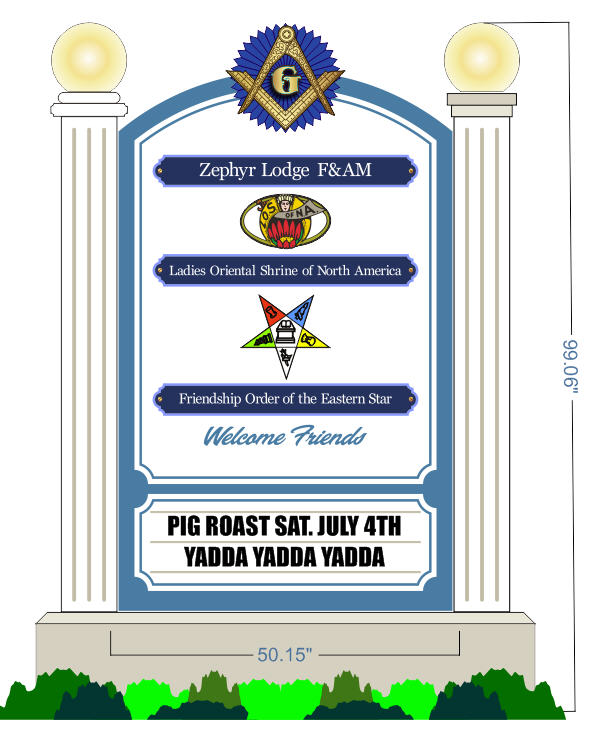

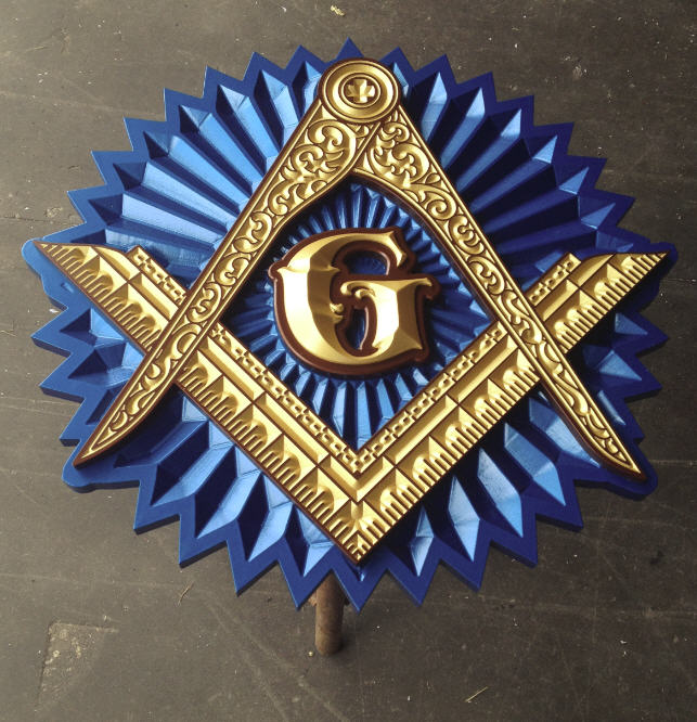

Designed and in production of a new Masonic lodge sign that my business partner belongs to. Here's the concept drawing along with the centerpiece compass and square logo. The rest of the sign is coming along nicely. Fluted columns and big shiny gold balls and caps.

I assume that it's HDU and gilded?
I would love to see a step by step on this one... (ok, a step by step on anything you produce)...
SignManiac
Wow...just, wow.

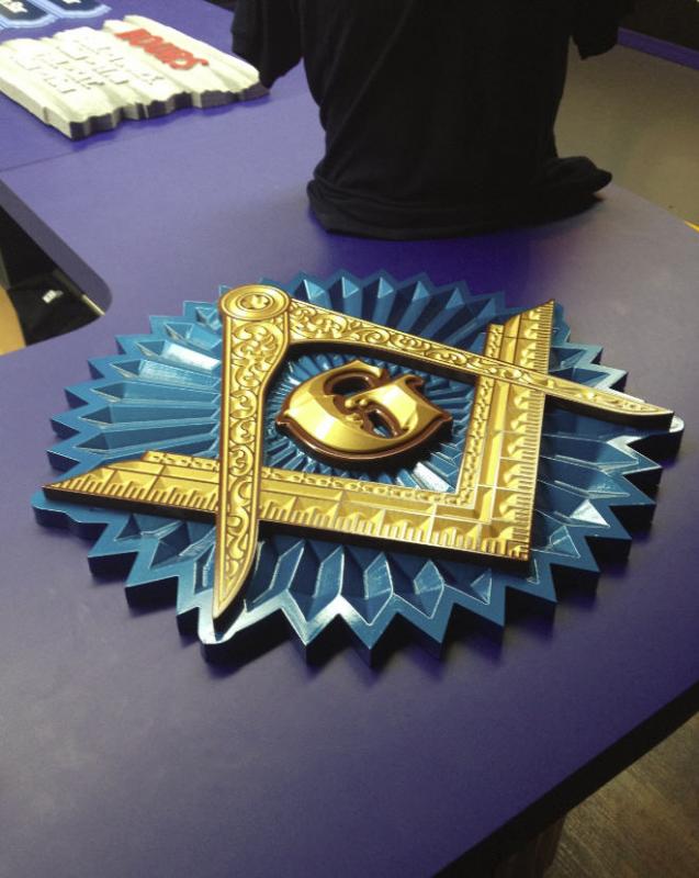

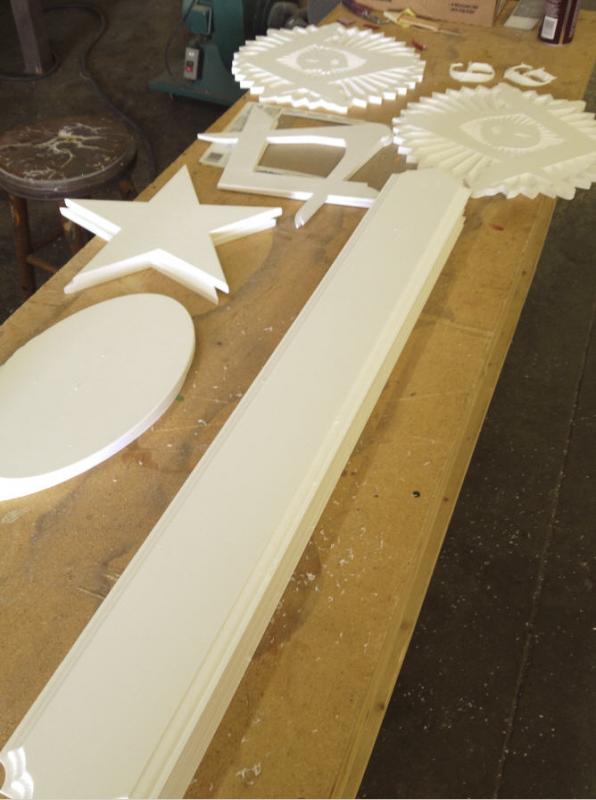

Entirely PVC and all Matthews metallic paint with a gloss clear coat. Here are a couple of shots I snapped along the way.

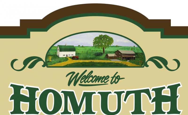

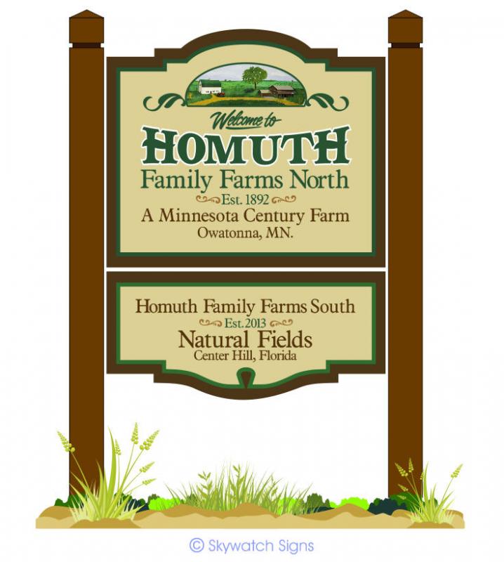

Here's another one in the works. The farm scene is hand painted with 1-shot enamel and then will be digitally printed because we're doing two signs for them. The pictorial is based on their farm in Minnesota and their farm here in florida. They wanted to blend the two farms into one painting.

Kottwitz-Graphics
What thickness are you starting with? Is it one piece, or layered? How are you dealing with the movement of the material? Or is the paint sealing it and helping to prevent any warping?
sorry for so many questions, I'm just so inspired by your creativity. ... teach me, Master.
SignManiac
All the layers are cut out separately, then painted, then assembled from bottom to top. Mostly 3/4 and 1/2" material.
Farmboy
Love your attention to detail, even on your proofs. The grass, weeds and dirt weren't really needed, but shows you care.
