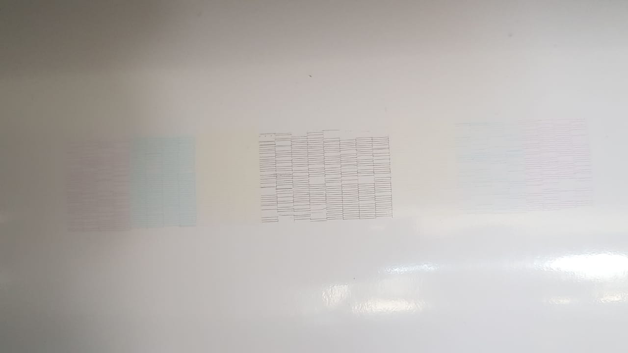

erikjem
i took apart the printhead, clean manifold, this pic is what i got today , im happy because i think the problem is not in the head,
will keep cleaning
regards
