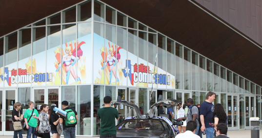

What's the problem with the 2ft x 2ft size? Is it just the installation that's the problem?
We did graphics for a comic con several years in a row. One was a massive, multi-panel section graphic for the main entrance. One year we tried static cling to see if install would be easier. It held up just fine for the event, but got destroyed in removal just because of the size. We went back to a low-tack vinyl because of price, but didn't have any issues with that large a scale.
attachment.php
I would think if static cling was ok for this large a job, it would work fine for a 4 sq.ft. piece.
attachment.php
Am I missing something?
Yup, you're missing something.:Big Laugh It's a client install and they've never done it before. I may send them a comp to play with. If they don't have installation issues I'll have my answer.
