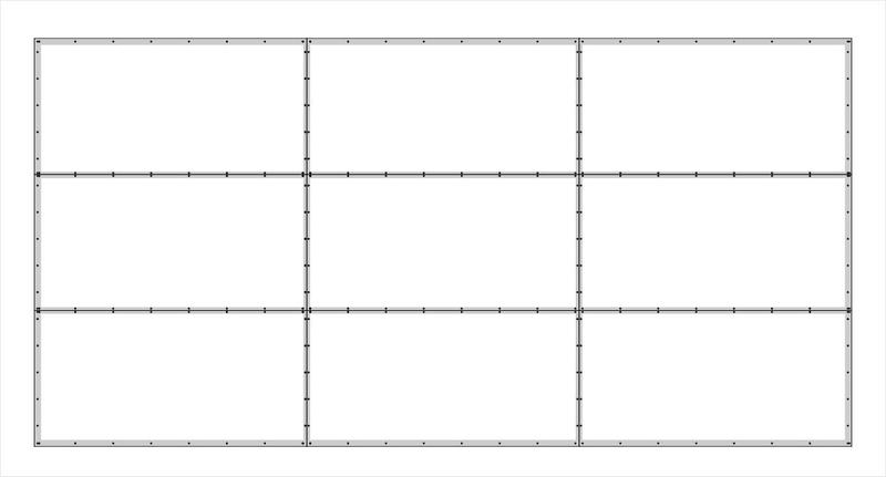

We got a job to make a 24' x 12' aluminum sign (9 sheets) with vinyl on it.
It will go on a corrugated metal wall.
What is the right way to do it?
I like how aluminum pan signs look, but I believe its not possible in this case, because there should be no gaps between the panels.
The grey lines on the attached below are 2x2 aluminum square tubing. The maxmetal sheets will be attached to the aluminum tubing to prevent it from waving (corrugated metal wall).

You really mean 12' x 24', don't you ??
Anyway, you didn't mention what thickness your ACM is gonna be, but you're gonna need more supports in there or you'll have sheets bowing in and out all over the place with that configuration.

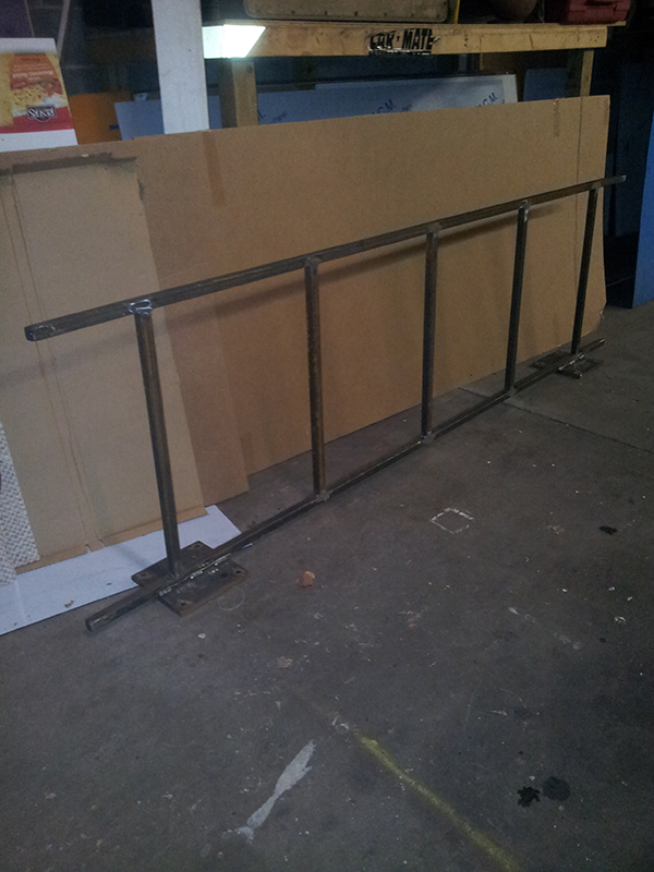

Here's one we're in the middle of doing. This is for a 120" x 36" and we're using 10mm ACM on both sides. It will be lagged down into two brick pillars about 28" out of the ground. It might be a little overkill, but I don't hafta worry about a thing. The steel cost me $35.50 and took about 2 hours to cut, weld and grind. It'll take another 1/2 hour to put the rust infusion on and another 1/2 hour to paint it.

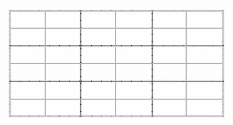

Should we build the frame at the shop?
I was thinking about putting the aluminum tubes to the wall and than bolting the maxmetal to the tubing.

How high up on the wall is it going ?? Will you, along with others have easy access to it ?? If so, so will vandals. Hopefully, this is going to go high, or in an area where no one can get to it. That would be a very tempting canvas for graffiti artists.
Regardless of where it's going, think about it......... if going on a wall, it will be a little hard to transport and if you can, you'll need a crane to hold it while lagging it on. Probably build it in 3pcs 12' x 8' and then put a connector in the middle to make sure no lumps or dips will telegraph through. Then attach your face panels. Again, you might need a bucket truck or knuckle boom to get them on there.

We did a very similar job. As Gino suggested we had more struts and built it in a few sections to ease transport.
On site we assemble it into one piece. we set the bottom brackets ahead of time. Then it was picked up with a crane
and rested on the bottom brackets while a guy in a bucket did the fastening.

are you just skinning both sides of that with acm? you might want to weld upright tubes on the ends also to close up the ends so it looks better from the sides and doesnt turn into a nest for critters
ACM on both sides with a pre-bent aluminum 'U' shaped end cap which will be riveted on..... on site.
