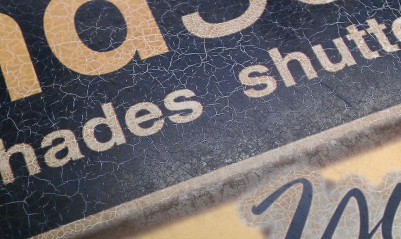

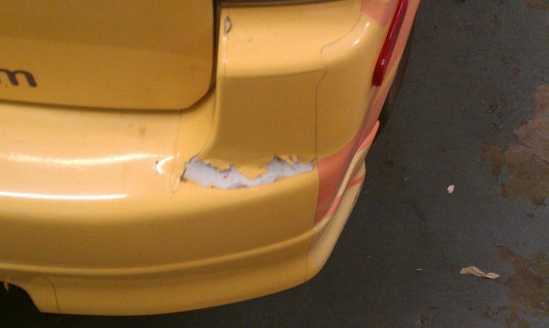

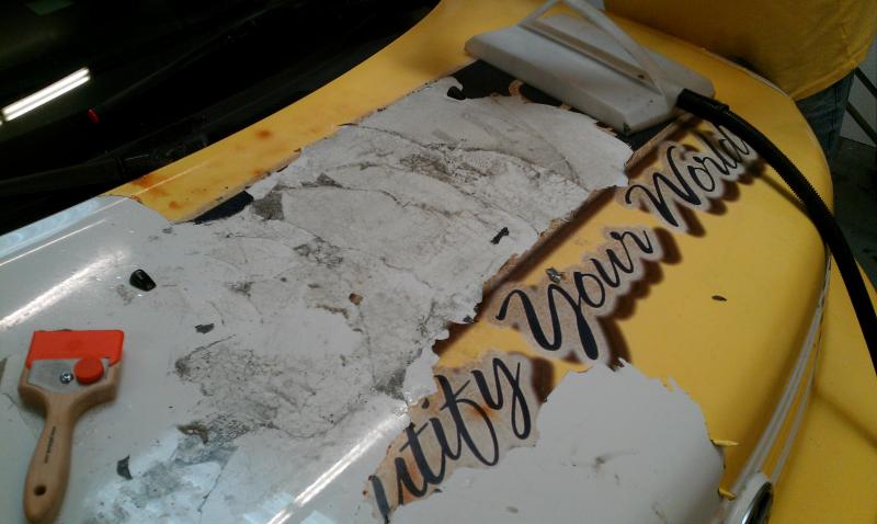

We bid on this job a while back, didn't get it.
So they come back with this. It was all Permanent calendared vinyl, cracked, burned, looking like AIDs.
Now we got to redo the whole thing. After paying for the full wrap - ~2400 they couldn't afford the full wrap again, so we had to do a partial for them.
The type of sign shops that do this, make my business so successful. I love it. So, if you're using calendered vinyl for wraps - stop. It may look pretty when leaving, but give it a couple months.

How the heck can you do a wrap with calendered vinyl? The hood looks pretty typical of calendered or even cast after many years.
How old is the wrap?

wow that looks like it's been on there for years. also looks like it sucks taking it off. good luck with that one
It's definitely possible. There's a shop here in our town that does this on all of their wraps. We've redone a few of them, one seemed to be Oracal 3165RA and one looked like 3M IJ35. But they charge less than half of what Colorado's competition is charging. It takes some balls to charge $2400 for a full wrap on a minivan and still use calendered. Not that $2400 is a lot, we'd charge more, but that's a lot for a hack job.
The bad thing about our friendly competition is they'd have charged $1000 at most for that job. I've actually had people say to me "well, you're more than 3 times more than XXX signs, but even if their job fails once or twice in 5 years and I have to pay to have it redone, I'm still saving money vs going with you". Unbelievable...

We just picked up a fleet job that looked pretty much like that. They brought the first truck in for removal, and we did it for free with the understanding that we would base our price for future removals on how long this one took. It's a re-brand job for 121 trucks.
This is the second fleet package we have gotten for the same reason.

Gee Wow is right! Thanks for the pics, I won't even consider calendered for anything like that now. Well worth the price to buy the Cast!
HulkSmash
Man it's sad..
Shops around here, use IJ35, for wraps all the time, and charge, and TELL the customers it's cast vehicle vinyl. I feel bad that the customer get stomped.. but nothing i can do about it.
