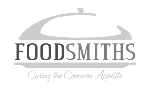

On my lunch break so I'll toss this out for another direction.

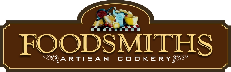

SignManiac
One more quickie on the lunch break... Pictorial is recycled from a job I painted about twenty five years ago.

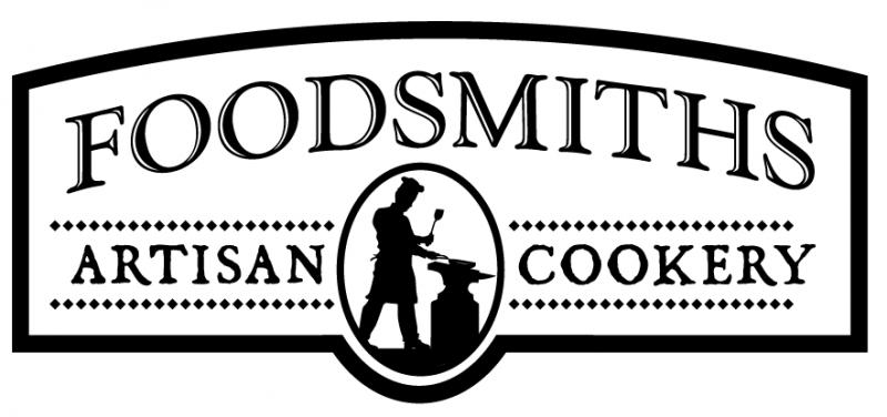

sinetist
Wow .... lookit all theses great ideas flowing. I just spent some time toying with the anvil/forge idea (while the latest designs were being posted) and came up with the attached pic. I've spoken with him again ... he loved the Artisan Cookery tag and tooled font for the name and liked the rules made from diamonds. The Chefsmith may be more graphic than he has in mind but I'll run that by him. And all these latest ideas! .... liking them all and adding them to the drawing board for some further consideration. Thanks a lot everyone. It's very inspiring and educational.
TheSellOut
Yeah!! I liked Circleville's anvil idea and you pulled it off b-e-a-utifully, great graphic!....I would just even out those diamonds!

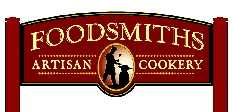

sinetist
Thanks .... Evened out things a bit more and added some color (I'm going to talk him out of green - the burgundy is much better looking, I think). Here's what I'm sending him. I got a feeling he's going to like this one.

TheSellOut
That really looks nice sinetist!! I'm not sure how it would look be maybe try changing the outline of the Chefsmith to black and have the gradient go from white to the gold or beige color!
Fitch
Not bad but IMHO either introduce burgundy into the sign or change the posts. They look too separate - as if the posts have no right to be there.
ALL conponents need to compliment each other and a part of the sign in its entirety.
TheSellOut
That really makes the sign pop!! I don't mind the green or the burgundy. In my "Victorian" town it is played out though, our planning committee thinks that those two colors are the only two victorian colors. And I do agree with Fitch on the posts but I would change them to black, possibly with gold/beige caps!
