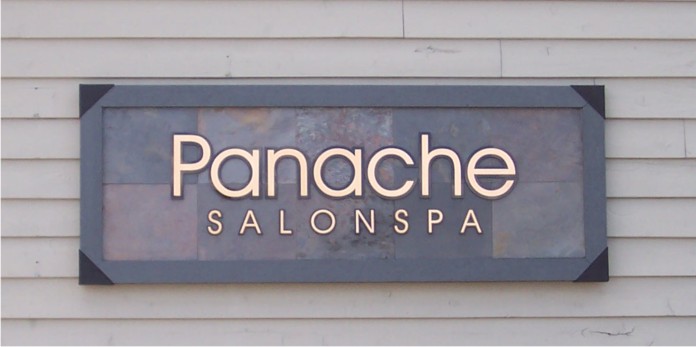

Here is a sign I did a few years ago with slate tiles as a background. Made an aluminum frame and attached dibond to that. Mounted tiles to dibond. Gemini custom copper letters with an acrylic outline/background. Heavy as hell!

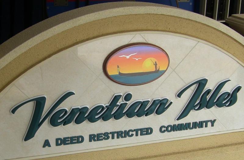

I've only used it for facing a monument sign. Here's one I did using an imported Italian tile. The only problem I had working with it was drilling into it for my studs to mount the dimensional lettering. This crap was extremely hard to drill into.

Adhesive can work but, over the years I've always used both mechanical and adhesive for extra insurance. It the glue should fail, then you have the studs as back up.

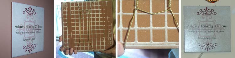

We print on them. They are ceramic so would work good for a back splash or wall, I would not use for floor because that should be porcelain only. If you look at that back of the tiles it has the grooves for the thinset, I would be careful with the grout though as not to touch the printed area, as well when doing the final buff to remove plaque_filmstrip.jpg hazing.
