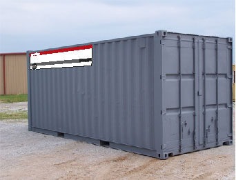

Zazzess
There ... bad picture but its about what we might get...

The congregations can be wrapped, you have to add the excess into the overall design. May not want to be your first wrap, but hey.. it's a container not a ferrari.

I would test one of the following:
General Formulations Moto Mark
FlexMark Billboard RTS
MacTac HTO
Motomark is probably the most agressive. Moto Mark and FlexMark RTS both have a really thick adhesive which will help to adhere to this product. I would not claim for either to last over year though.

mountaingraphic
Awh good ! Now I feel cheap too :O lol
Sry not usually speaking english... what excess are you talking about ?
:iamwithstupid
Thanks for your chears :tongue:
You will need to compensate for the peak and valleys of the container during the design. I believe this si the excess that is being mentioned. There was a post not too long ago where someone was trying to determine the exact amount of excess to add and they had a formula to go by I believe.
