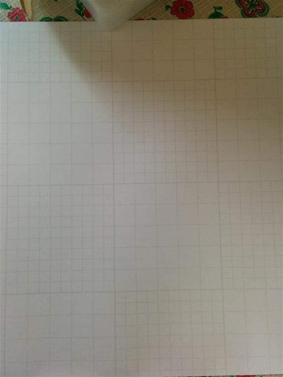

We are being supplied black carbon fiber vinyl rolls with an OEM plain liner (see attachment) from a certain make in china by our client which he wants to get it on a branded liner with brand name on it instead of being plain. He is getting it packaged for retail sale under his own brand and wants even the stickers to be with his brand on the liner.
Might be his vinyl supplier wants a high MOQ to get the brand name on it or may be for some other technical reason would have been unable to include the brand altogether. Wanted my question to be very simple. So didn't include all the details. Didn't know I had to explain my business ethics behind it.
We are using an FC7000 to half-cut the stickers. The stickers are stiff enough to be transferred without getting garbled.
We were just looking for a work around to get this job done cost effectively and with minimum labor. Will be glad if someone here genuinely has some suggestions that might help someone being from the same industry. I thought that's how it worked here in forums.

The release paper with the logo is being supplied by the client himself. We are not printing it. Each job would be 24" width (thats the roll width) and around 7" height. The stickers come off quite easily from their original liner. Also there is no issue of dust since our facility is dust free. Is there any way I can use a transfer sheet and get this done job by job? A low tack one may be.
