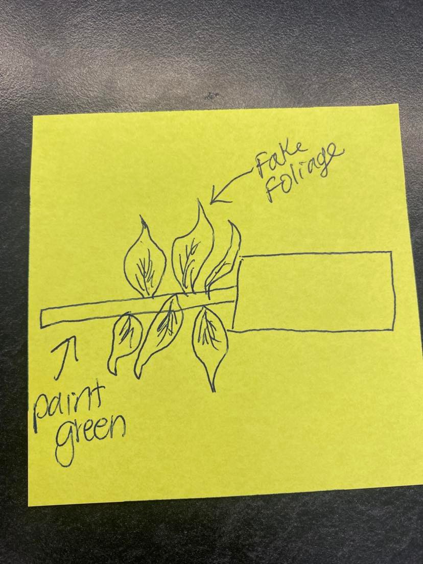

Actually, RJ's got a good idea. Once you create your mounting system you can order fake foliage to match this type of shrub and you can then attach some to each of the rods after you paint them green to match the shrub.
Maybe you can make this thing detachable from the mounting plate for the landscaper. He can take it off, trim then put it back on.
