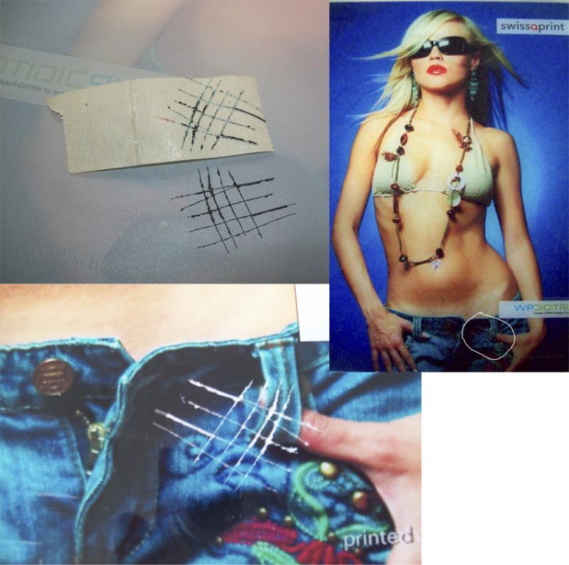

I was at the ISA show and we had the first US showing of the SwissQprint Oryx UV flatbed printer. We printed on Acrylic all day long. I first asked if it was Acrylic because the adhesion was so good. I was shown the label before removing the liner to print and it was Acrylic.
The SwissQprint Product Marketing Mgr. informed me they had their ink made to promote better adhesion on tougher substrates like Acrylic with additional preparation of the surface. The Oryx enjoyed a great 1st year in Europe in 2009 with 50 printers sold. Much of the success was at the expense of the Oce GT3XX/Fuji Acuity partially because of the good adhesion to Acrylic.
The photos attached are of an adhesion cross-hatch test I did on a sample from the show. I'd post it here but can't figure out how. The photo shows the tape and the cross-cut on the back of the print, which had a white flood coat on it also. There is also a close up of the front of the print and one of the overall print itself. I tested it in the darkest area on the print that would have the heaviest ink saturation, which is the most problematic in my experience.
