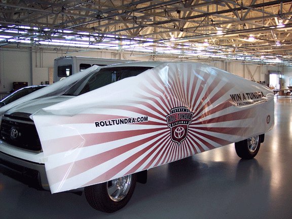

Hmmm. how about "no" seams

unfortunately for the OP this thread is worthless. you show me a cargo van you can do in one peice, and ill get on board. sorry toyota tundras dont count. nor do grapphhhhizzxx emporiums example of a truck (read up johnny, this thread is about a cargo van, not your truck example).
