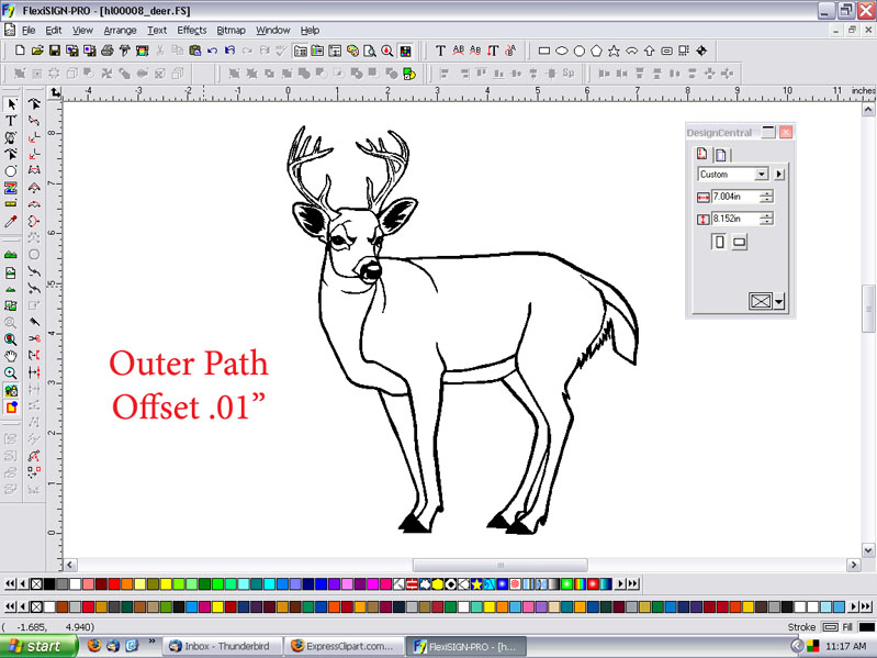

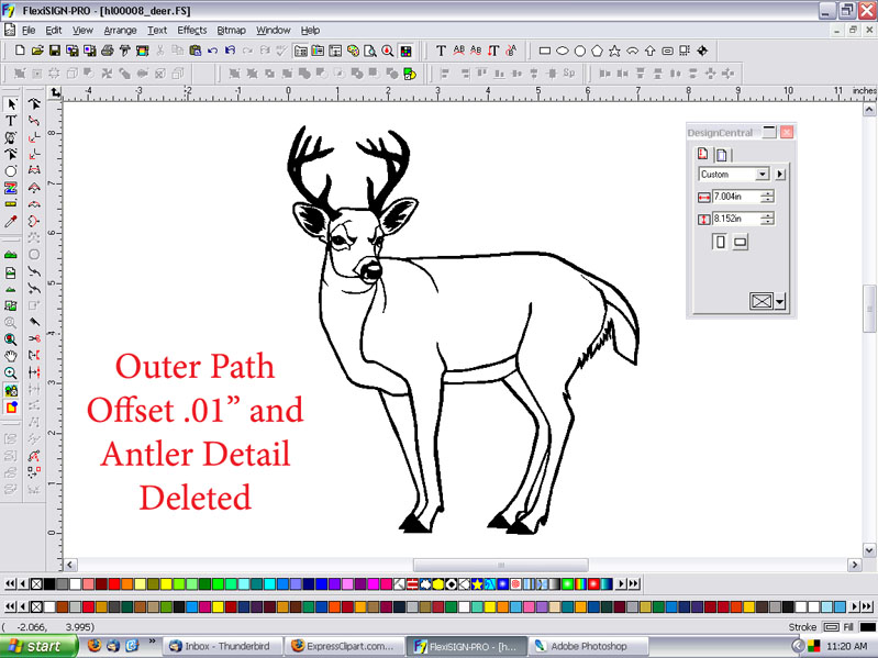

The answer is to simplify or embolden the work. Emboldening can often be done to selected paths using the outlining capabilities of most graphics software and not keeping the original path.
In the examples attached I have demonstrated a couple of examples. The same technique can be applied to inner paths where they are too thin for successful cutting.

I agree the more detailed graphics are more appealing for sure. That is why I bought the Mega Collection. I thickened up the lines on the deer and it looks good and I look froward to cutting it when I get to the shop tommorrow.
Question is, how do I fill in those antlers?
Delete the inside shapes. You will have to release the compounding and then recompound it after you make the modification.

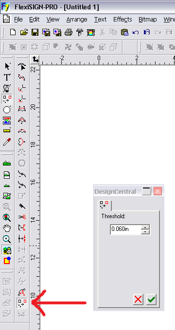

Flexi also has a tool you may find helpful that will automatically delete any selected shape that is smaller than whatever size you have filled in the Design Central box.
Fred Weiss
Merchant Member
It is called the Threshold tool. It is under the Node Editing tools and simply bears the Tool Tip name "Remove Tiny Objects". The primary use of it is for cleaning up after autotracing.
