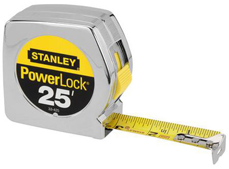

I find PVO to be quite accurate but I always rely on one of these to be sure.
