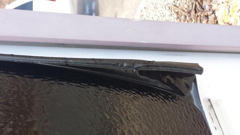

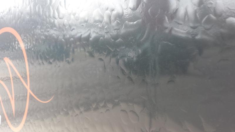

Hey guys....installed lamination on clear "briteline" vinyl on lexan two months ago and am attaching a picture of what it look like now. The art is all black except for a little orange in the logo portion.
It looks like alligator skin throughout all of the black portion of the vinyl. The colored (orange) has smaller insignificant bubbles and the black has major issues. This sign does get full sun and is backlit with fluorescent lighting (albeit older lighting)
The other issue is the peeling up on the corner. Was told that calendered vs. caste is a discussion to have as well but this was such a PITA, I don't want to spend triple the money on caste vinyl is this is just an outgassing issue.
Any help from the collective brain trust would be helpful.

Wow, that's a huge mess, huh ??
Never skimp on materials is all I can say. However,it looks like you have more wrong than just bad materials.
Is this your first time doing this ??
d fleming
Is this your first time doing this ??[/QUOTE]
Be my guess. Briteline on backlit lexan? Recipe for trouble. Also looks like it was laminated immed after printing possibly. Just a guess.
reQ
First of all, that vinyl is not really good vinyl.
But, you also would want your lexan to outgas if its new face you are making. After its cut to size, remove protective film an let it sit (i usually let it sit overnight)
Some people will disagree with me that polycarb needs to outgas, but i never ever have problem since i started doing it.
Rydaddy
Transclucent
Use a name brand Translucent (we use 3M 3630) media for lexan. Yes, it's more expensive. It's the correct product for the job. We apply with rapid tac, one of the few things we do that we don't apply dry.

It does not surprise me anymore, that so many people try to cut corners wherever possible. For me, it boggles my mind, that some one does not want to spend money on the right materials for the job.
Its like fixing everything with ducktape... but its cheap hey
Techman
those blisters have nothing to do with "outgassing". There is way too any blisters with too much volume to be outgassing. Outgassing is a myth.
Some will always blame outgassing for blisters on plastic.
The only way to avoid blisters on plastic is to either do it right with a properly sharpened squeegee,, or, flood the surface with a professional quality application fluid such as rapid tac. Thus floating the vinyl onto the surface.
That is an obviously bad install. That is all it is is. A bad install. If the vinyl is not applied with good techniques it will always blister on a super smooth surface like plastic. Yes it will blister even on powder coated aluminum as well. We had a guy who couldn't apply a layer of vinyl on the license plate aluminum panel if his life depended on it.. It would make others cringe when he would claim outgassing. It became a most hated word in the shop over it. He would apply it and blister. Another would apply it on the same panel and have a perfect outcome.
Same with plastic faces. One would apply and have a perfect outcome. Another would apply a layer and have pickle skin then scream GASSING.

So was it freshly cut piece of polycarb? Or you reused old face?
jman
Dang what a mess that is!
Briteline is Grimco's house brand for anyone not familiar. It's either re-branded Avery or General Formulations vinyls. I know they do offer a laminate with and without UV protection. Maybe it was the one meant for indoor applications without the UV protection?
Even if it's cheaper calendered material it should last longer than 2 months. That stuffs like super glue most of the time.
I've done a handful of back lit faces and never had an issue with taking protective paper off and immediately installing vinyl. Maybe I've been just lucky...Who knows on that.
I say check the materials and see if you indeed did buy the laminate for indoor applications so you don't have anymore failures due to the wrong product for the job then get the correct material and re-install. Good luck!
signs20
Problem/Solution
Lexan (polycarbonate) is hygroscopic - that is, it absorbs water. The bubbles are due to sun warming the Lexan and forming vapor under the vinyl.
This can happen with any type of vinyl if the Lexan has been exposed to moisture and is not heated or baked to drive the water out before coating with vinyl. That is why Lexan that has just been baked (for forming a pan face) can be successfully coated with vinyl.
3M and Avery, and maybe others, have detailed writeups on this subject. We learned the hard way about 20 years ago.
Acrylic is non-hygroscopic and can be successfully coated with vinyl with no problems.
Techman
That is a huge load of water under there. I do not believe it is water in the least. The volume of the blisters is way to high to be water or soap or alcohol..
Personally. I never ever had pickled skin after learning how to correctly apply vinyl apply to polycarbonate or acrylic.
Also, over the years I see so many posts that do not include all the data. Important facts are left out such as people using soap water, or some strange witches brew of a cleaner, or using rubbing alcohol, or mineral spirits to clean or any other of a multitude of errors.
There is more going on here than water vapor.
