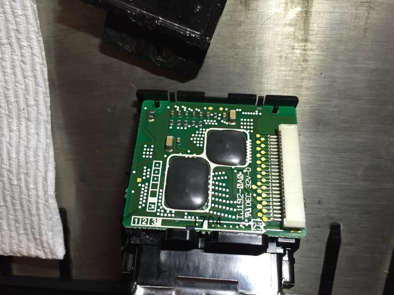

Yes, in the service manual, there is a huge warning about covering your boards while changing print heads. I changed two at once and payed strict attention to the service manual and had no problems. Im not saying that you made an error when installing, but it is a possibility. That being said, any service/parts company should treat every customer with courtesy. btw, I thought cmyk was a merchant member. I could of swore I saw a banner ad on signs101 advertising printheads for $750 or so. Could of sworn it was cmyk, but cant find them in merchant member area.

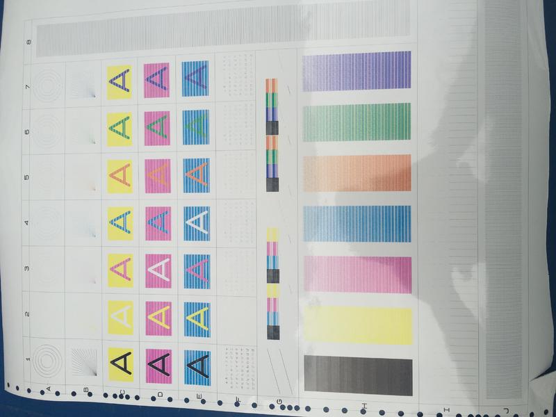

I cannot prove that I didn't mess the print head up. But I do know that I followed the instructions in the service manual exactly and read multiple other forums and blogs about how to work on this printer before I attempted anything. I have always worked on all of my things, from cars and trucks to heavy equipment and even my Gerber Edge. But the main reason I am unhappy and also the main reason for posting this is because of the fact that they have ignored me since they found out their was an issue. I did not send them an angry email demanding a replacement, I asked them if they had any suggestions that I may have overlooked. As soon as I sent the email with the picture of the bad nozzle check they stopped answering calls or emails. That is just poor customer service and poor business practices in my opinion, and I was hoping to keep another member of this forum from going through the same thing. And yes, I should've purchased everything from merchant members, but I was foolishly trying to save some money. Several of the parts did come from Solvent Inkjet, they were great to work with and I will definitely give them all of my business in the future.

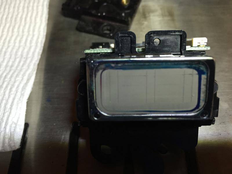

I pulled both heads just to check everything. As you can see in the pictures, there is no ink on the board and there was none on the ribbon cable. Everything appeared to be fine. I reinstalled both heads according to the service manual, and I still get the exact same nozzles missing in the test print.

I posted it in the thread I started in the Mutoh forum, but I'll put it here also just to see if anyone has any ideas. Just out of curiosity... if I would have goofed up and done something that "fried" the board on the print head, would it not be completely dead and not halfway printing? I only ask because I have no idea... I would think an electrical short would cause complete failure but I'm no printer expert.
