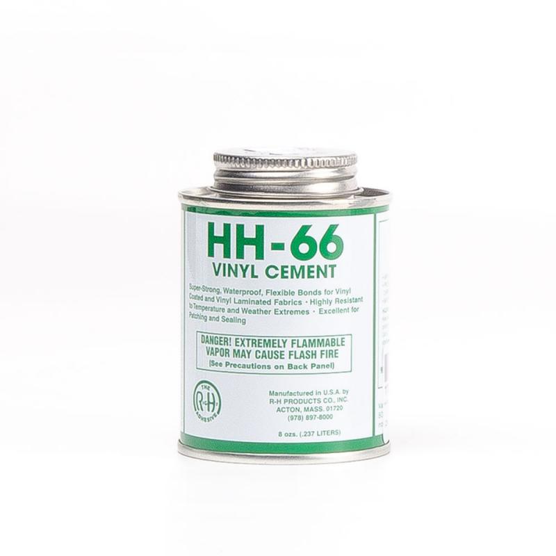

what is that banner bonding liquid nails stuff called?
Quark
Merchant Member
comes in a little tin can, apply with brush to bond two layers of banner together...? thanks!
Sign Works
HH-66 Vinyl Cement
MikePro
works great for patching holes in flexface & banner material. can't think of any other proper use for it.

A leister welder will be much better than that chinese thing.. 20mm seam is common for billboard flex. So it might be your heat and speed settings.. proper welds should tear the coating off the scrim. test each type of material before welding.
Yes those welders do stink, but only if you run too hot or too slow. as for the hh66 cement, it will stink more, and you could get an exposure issue off it. it does work for big welds, but drytime is an issue. it will cause inks to offset on contact hours after welding.
