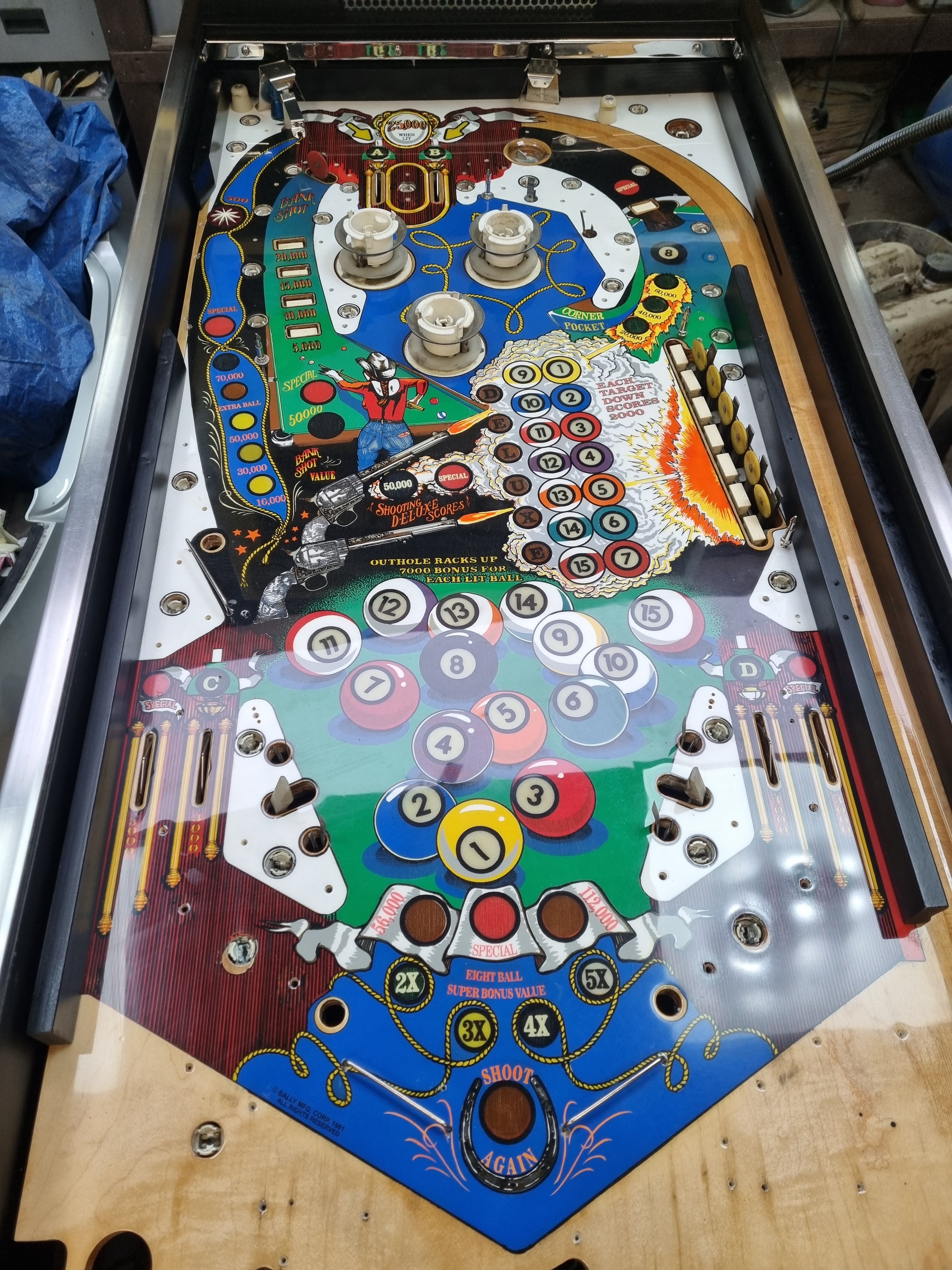

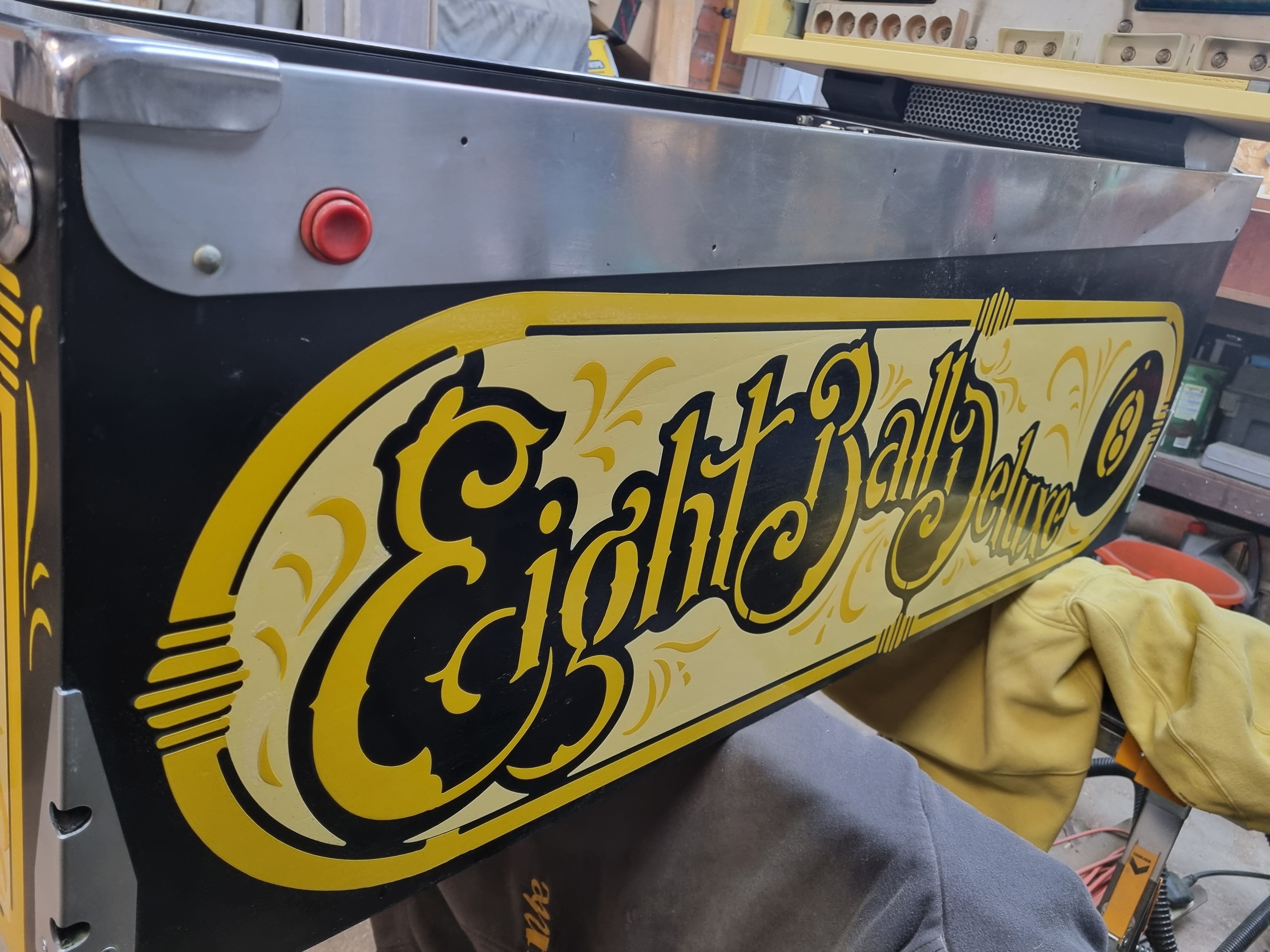

BTW Thought that I might show you all my latest resto job. Cabinet repainted using stencil vinyl and playfield restored completely, using stencils, water slides etc. Still lot of work to do for the owner but I've been only asked to do cab and the playfield.

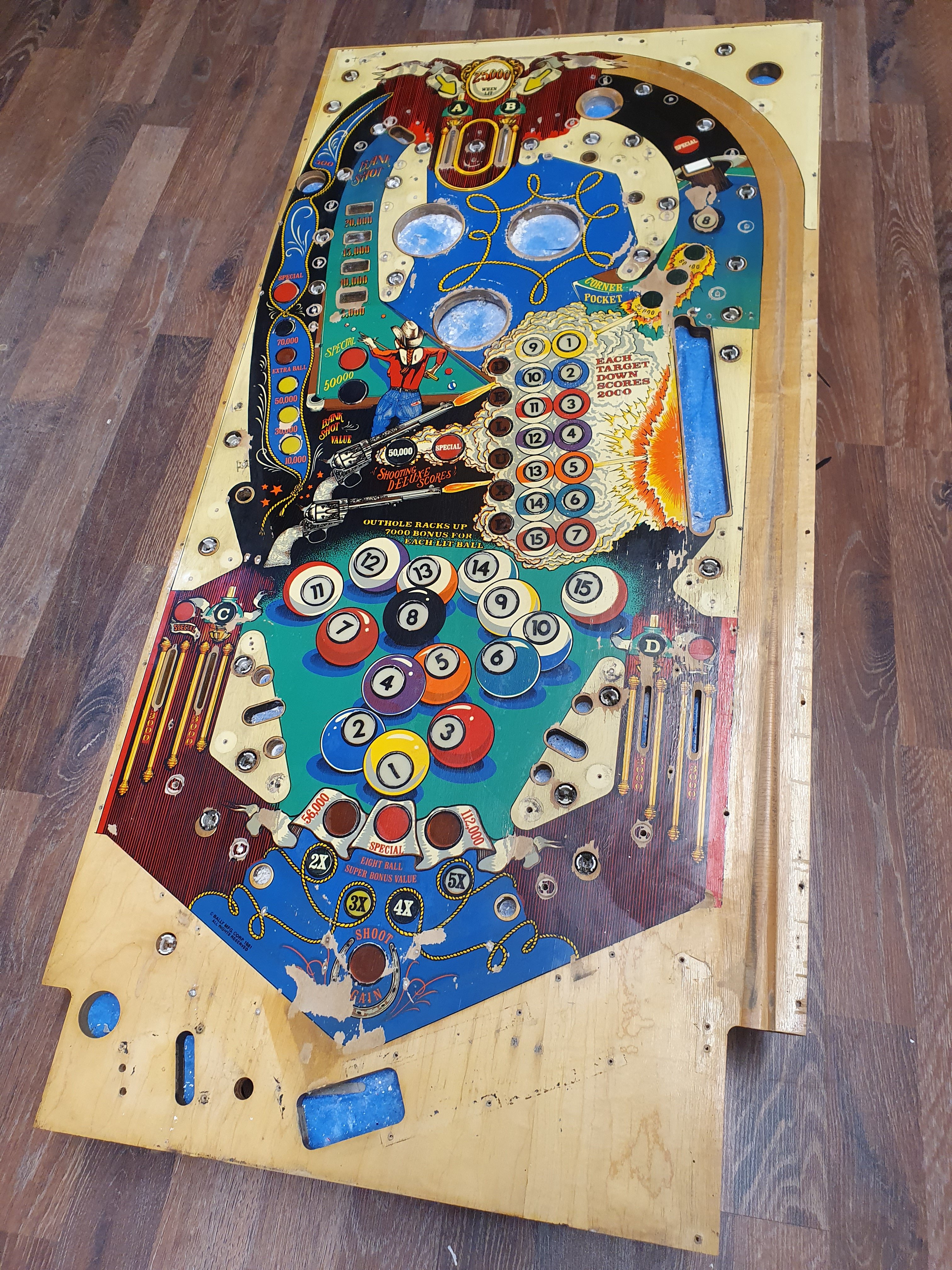

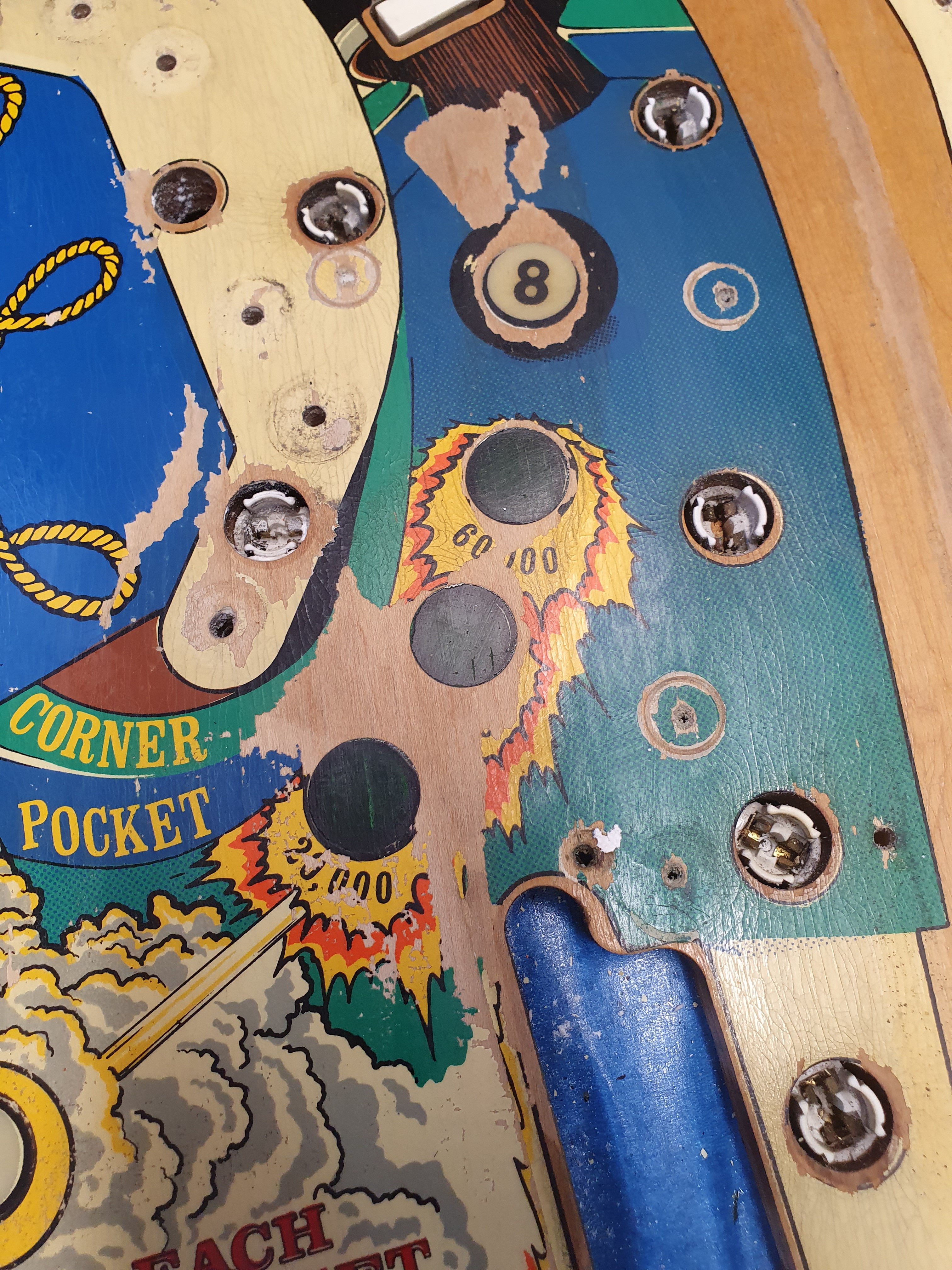

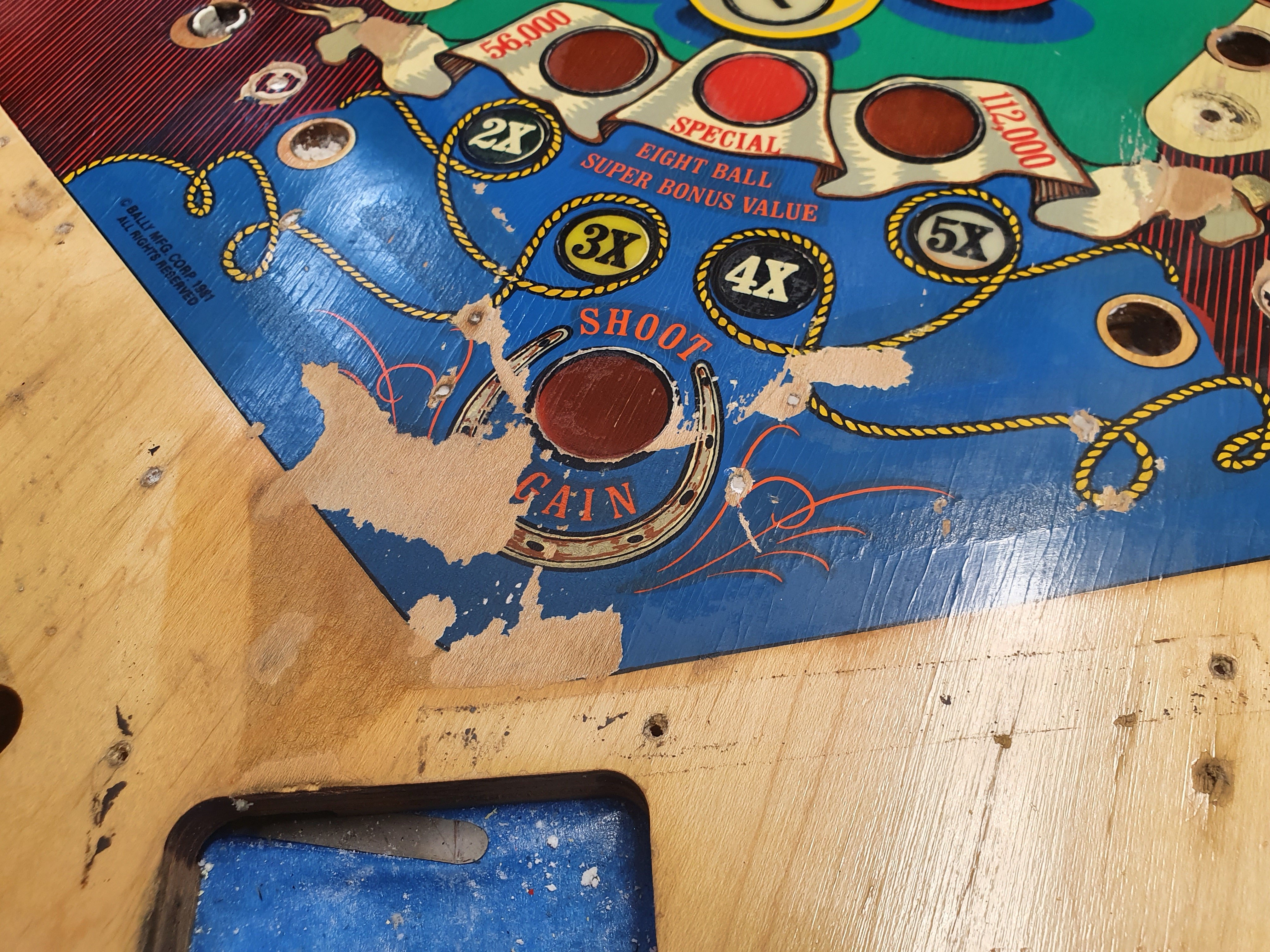

Playfield prior restoration
