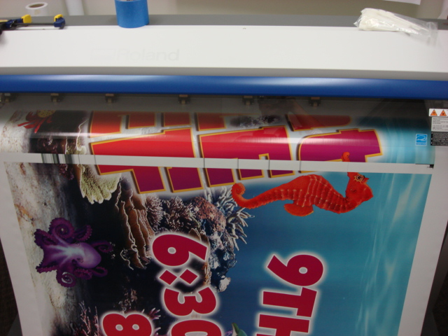

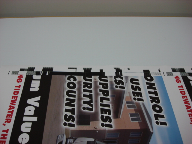

So the other night at 3 for the first time, the printer went crazy and started printing barcode like images in my print.
Now Last nite, and today, the same thing ...
What is going on here ?
I would first look at communication issues on your network or USB interface.
Has anything changed that would correspond with the onset of the problem (changing protocols, added or removed equipment, new router or ISP)?
Bob
UVchick
When it happened, was there any other equipment that usually isn't on at the same time running?
Fred Weiss
Merchant Member
First thing I would do, if you haven't already, is to reboot the computer and the printer. Next thing I would do would be to delete any secondary files with job parameters in them that get generated when you send the job to your printer. Then try it again and see what you get.
Chad.
The computer is a dedicated computer, only program running was versaworks, restarted it, i only import one job at a time, and delete completed jobs ...
this. sucks.
Fred Weiss
Merchant Member
Restarting Versaworks is not the same as rebooting the entire dedicated computer which will clear any issues with operating system errors. Same is true for the printer. Try it ... it might help.

To me it looks like the ink firing electronics are messed up. Loose cable or electronics have gone bad. I don't this it's communications because most printers are driven by some kind of language that follows a strict syntax and if not followed you would be getting error messages on the printer because the printer's firmware was unable to process (understand) the commands.
D
DARLAK
Guest
I had a similar problem with an old, very used FJ52 SolventJet. There was a lot of ink splashed up on the ribbon cable, right where the cable folded against the back of the printhead. The ink melted the cable just enough to short out the cable. $12 later the problem was solved.
