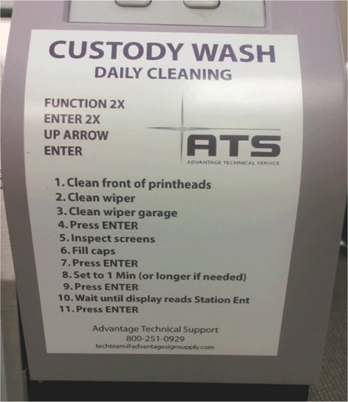

All I know is that when I don't clean it...the heads get some pretty nasty build up under them. I clean the wiper, and the station where the heads sit, then I clean around the four color nozzles on the head. I probably do it twice a week. Here is what they stuck on my printer direct from Advantage. They've seen it all, good and bad...so I'm thinking there is a reason they advise it.
