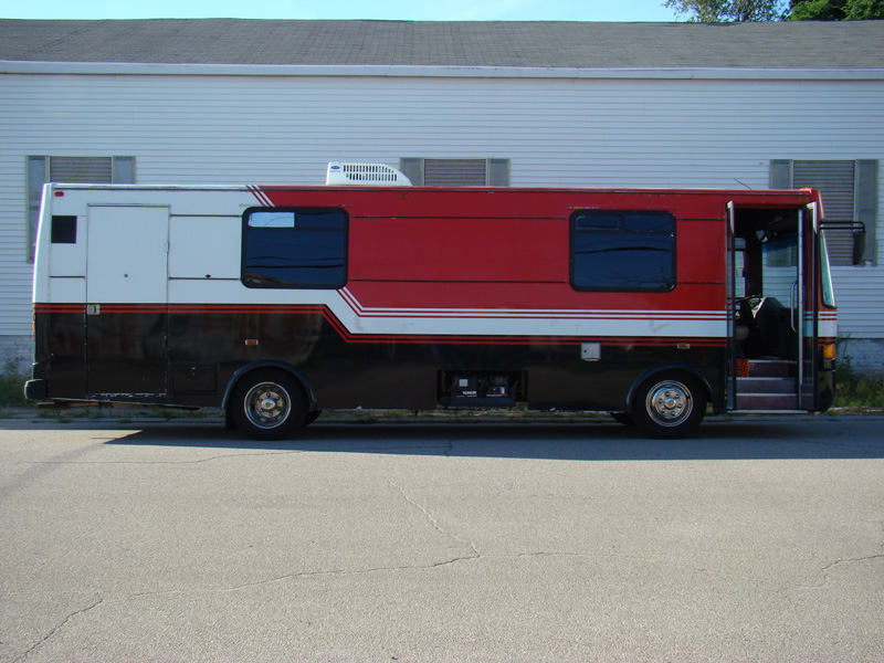

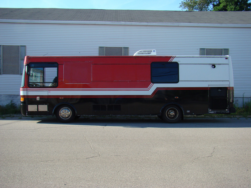

554 sq feet total for a FULL wrap on this old party bus.
What would you charge using high end 3M wrap vinyl and lam, and also what would you charge if you used a lower cost vinyl like or oracal 3551RA (if you have any other cheaper vinyl suggestions that would work for this application please let me know)
I quoted the customer $7200 (using 3M)
I get a email back saying they got a quote from another place for 4500-$5000
So is my price way too high or what?
This wrap is for a political campaign that will be used only til November.
I have the bus on my property right now and they are about to take it way if I dont give them a better price.
It wont let me upload the pic of the bus on here for some reason.
401Graphics
here is the bus

HulkSmash
for that short term, i'd use general formulations Automark concept 230.
half the price as 3m, and will be perfect for the install.
5k seems reachable with this stuff
