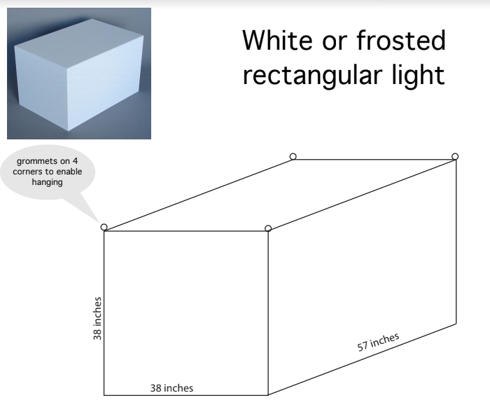

The question is how to attach them in the middle of the box. It's 38" x 38" x 57"
Should we make a smaller box out of clear acrylic inside and glue the LED's to it?
Devon19515
Get some wide angle lens LEDs and place them on the bottom center. May need to play with the quantity to get the brightness you are looking for. The frosted/white acrylic should distribute enough at that distance
to keep from seeing hot spots but you may have shadows in the corners. EDIT: you are wanting to illuminate all 6 sides? I would "suspend" a clear box in the middle to support the LEDs pointing in all directions.

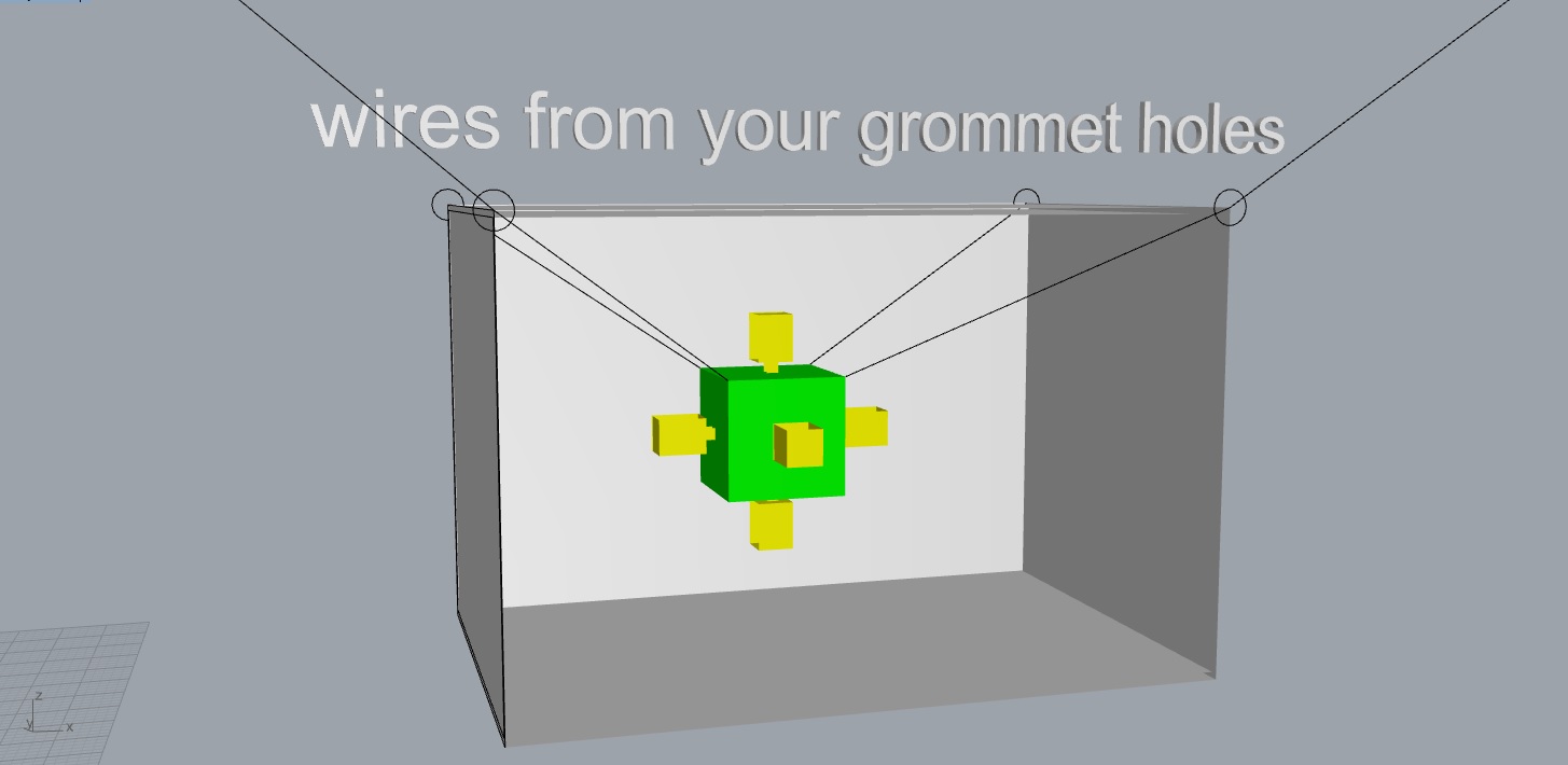

Your box in a box idea is good and it seems basic enough to bang out in an afternoon. The style of LED bulb I would use for this would be https://www.mcmaster.com/1638N335/ . That should have a 360 degree light and should be easy enough to screw into sockets. Makes electrical easy to pull off and LED power supply can be stashed inside the socket box. Just hang it from the same hole as you do your grommets. You could even use high strength fishing line that's clear to avoid any shadows being cast but you will need to run power on one of those fishing lines into the LED supply or sockets.
Not everything has to be engineered out the ass to work. Drawing not to scale but just an idea. Don't sue me.

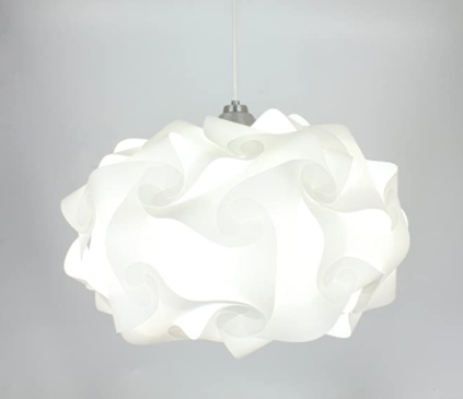

The total calculated weight is close to 80lbs if we use 1/8" acrylic.
I'm thinking we should try this plastic instead.
Who knows how it's called?

Probably some type of thermoformable plastic that's translucent. ABS would be a prime suspect. Maybe styrene but it's usually quite opaque. Perhaps making a fabric face instead of a plastic one might solve your weight issue.

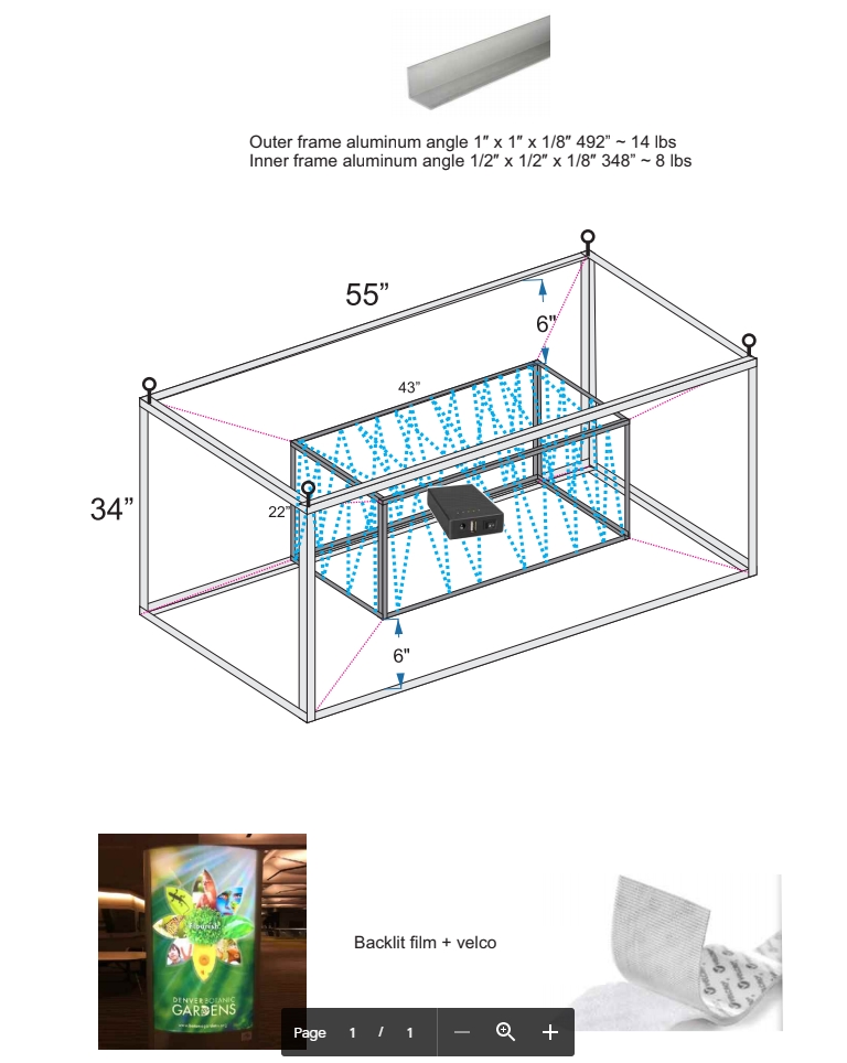

It's a job.
There's the current blueprint.

You could try to make the whole outer box out of clear acrylic square rod instead of aluminum. Don't need anything special to glue acrylic, just some plastic glue. I have used the weld-on brand with a lot of success but your local supplier will more than likely have their own brand of special plastic juice. https://www.tapplastics.com/product/plastics/plastic_rods_tubes_shapes/square_acrylic_bar/150 something like that is what I mean by square acrylic rod. Should cut easier than aluminum on most saws.
There might even be acrylic square like you are using the aluminum. I found this so far
https://www.tapplastics.com/product..._tubes_shapes/clear_square_acrylic_tubing/142
I hope your project works out for you. It's always nice to see more than just sign job discussions on this forum.
