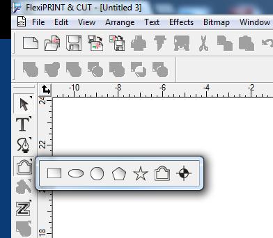

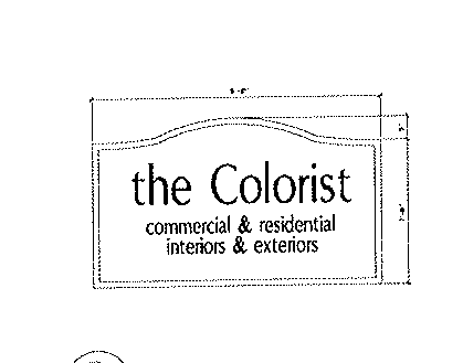

So I guess since it is Monday I am fumbling but I have spent the last hour trying to draw this simple shape (my pen tool must be mad at me) because I don't have it in Flexi does anyone know if there is somewhere I can just get this shape or what it is called so I can search for it.

It's a sign shape.
There are a lot of these sign blank shapes available online as vector art.
Or just draw a rectangle, overlap an oval, weld, then node edit.
Flame
Need to either get friendly with beziers, or do like I did and draw a square, then a circle, combine them and delete 2 nodes.
4 variations attached.
  • colonist sign.pdf
