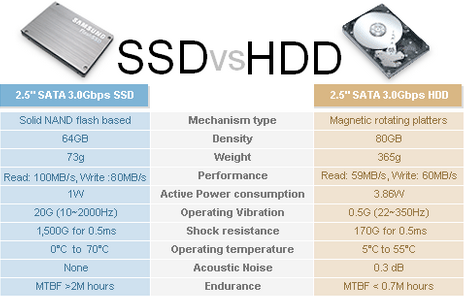

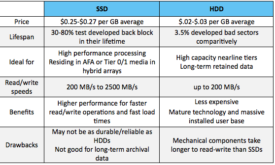

Jeff grossman
Living the dream
oldish data but still accurate
Those read/write speeds for platter HD are max & based on drives that have extremely fast rotations.
My gaming Cheetah HD was (from what I remember) 1,200 rpm, was very expensive and had a small storage, 7,200 was typical for hard-drives
