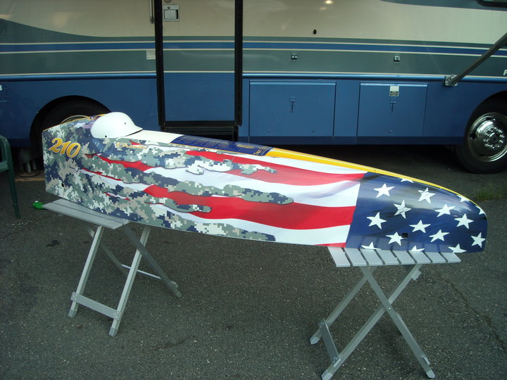

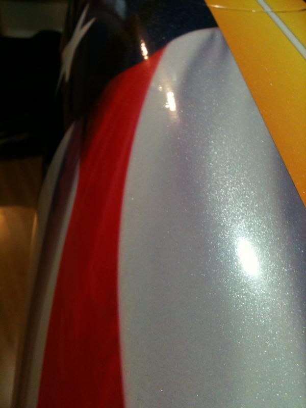

Yeah but then we would have to laminate over the printed laminate surface. HeHe. That would be one thick print and a little more costly.
We do something similar for our city's wayfinding signs. We get high intensity reflective stop sign gauge aluminium from the city, who gets them for a lot cheaper then we can. We print the layout on clear, then laminate that and install it on the reflective blanks.
I'd have to ask chris at AZ Pro. He does all my printing.
I've been working with Chris on a few projects. I'll pick his brain.
Printing on metallic would look great!
Other then the dull colors, it looks pretty darn good on silver. If it were on white I know it would look even better.
