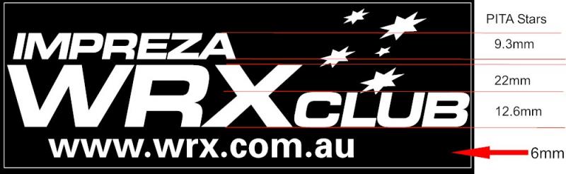

I find that every brand I have tried sucks when it comes to weeding white, yet have no trouble "Hero" weeding any other colours. I had to do 2 lots of 800 60mm x 170mm white stickers for a WRX club in white and not only was the text small, there were 5 small stars as well.....what PITA, nearly done my head in.
