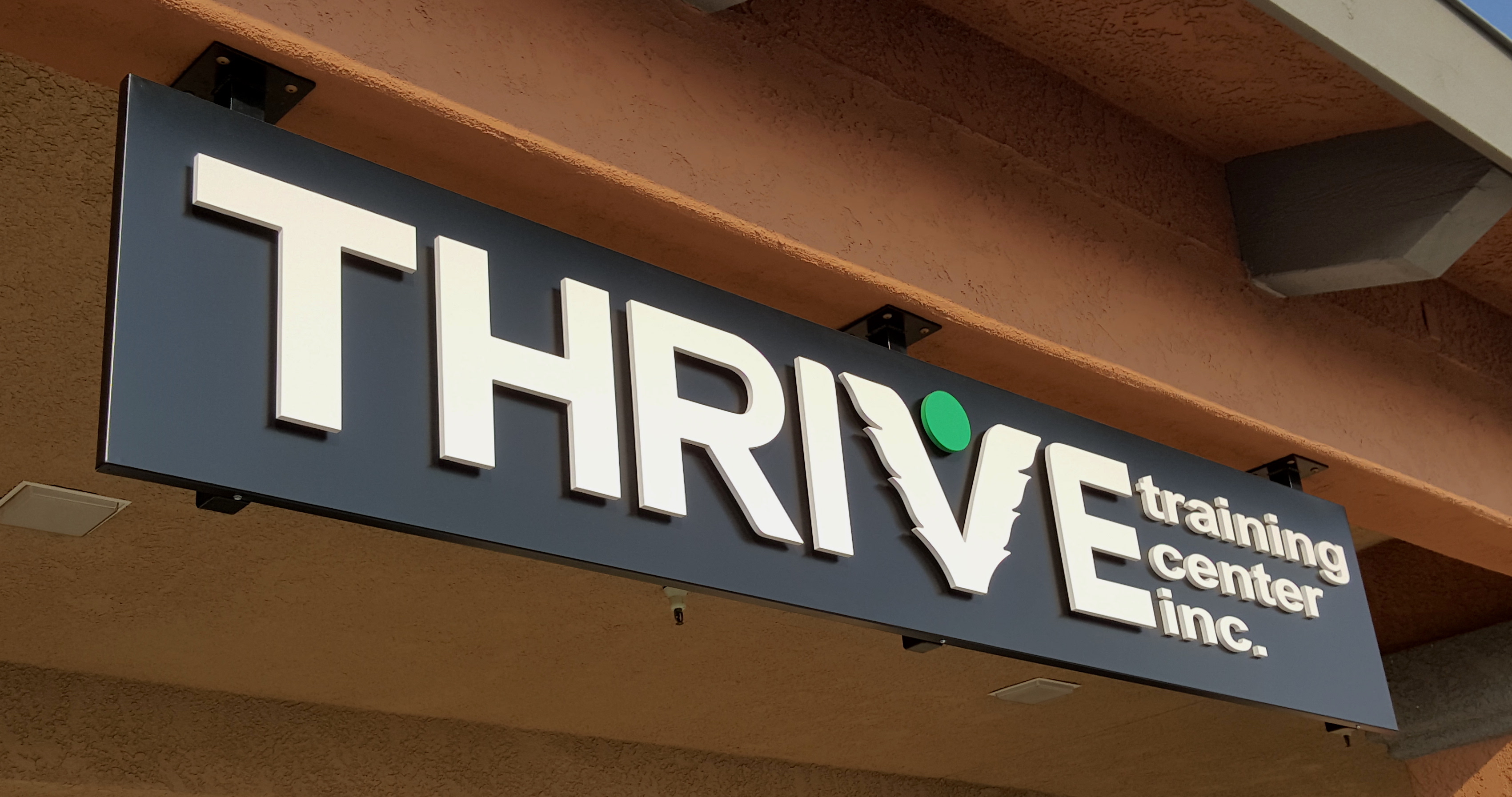

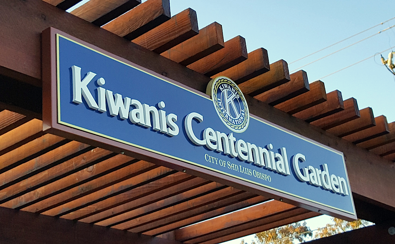

TimToad
thanks for your response. Is there a different material I can get that's 1"thick that wont warp?
When you say a backer, do mean a background panel for all the letters to be mounted to and fit within?
If so, why not just use a formed aluminum panface as suggested by others? You get a nice rigid panel that can be painted, powdercoated, wrapped in a vinyl print, easy to mount and it allows you to use threaded studs on your letters and nut them securely from the back. The cost, weight, professional look and finishing considerations are all positives.

Okay, so this sign is 6' tall and 15' wide and already in place with aluminum sheeting for the face ?? You can't get to the back so you cannot double nut them. The PVC backer is really like a return, just to give the aluminum letter some depth ??

Thread pirate. Tim, those signs are nice. I'm curious, how did you do the Kiwanis sign with the bubble top? Is that just a separate piece attached?
TimToad
Thanks. Instead of dramatically raising the cost of what was a partially donated project by having the panface itself include the rounded top, we just took a chunk of PVC the same thickness as the depth as the return on panface, painted it to match and adhered it with a LEXEL, VHB and a few screws to the back of the ACM panel and panface.
