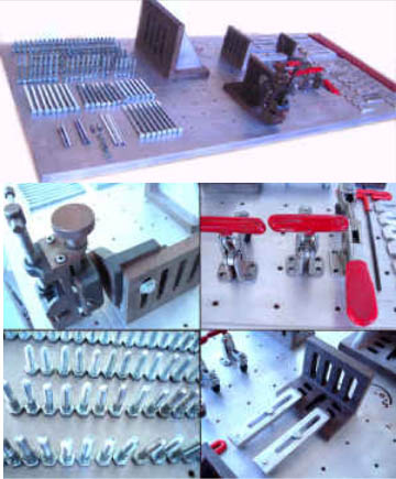

Anyway, a neighbor is selling a set of small clamps & hold-down tabs and screws, along with an aluminum surface with a series of threaded holes for attaching the various clamps, to use for clamping down work for CNC routing.
I can see how I would be able to screw (or clamp) this aluminum surface to my spoil board, even add a mini spoilboard on this aluminum surface, calibrate the table to recognize the new surface, & then with the use of these hold-down tabs, clamps, screws & the tables gridwork of threaded holes... there is the potential to assist with holding down smaller items that could then be routed into, & even cut out. (into the mini spoil board)
The question is do any of the more experienced router owners think this "kit" has a better than even chance of coming in to use for me some day? So far, I have not had any need for such a complex hold down system, & have screwed items right into my spoilboard in the past, when an item is not easily held by my 20HP vacuum pump, for whatever reason, however I do recognize the time that can be lost in figuring out a custom jig for a multitude of possibilities going forward the next several years. I also recognize that whenever new tools present new solutions, then things I might have thought I couldn't do will become possible, or things that seemed time consuming or even cost prohibitive will possibly turn into profitable jobs that i otherwise may have passed up.
So, to me, I believe a price of $325 could be recovered the first one or two times this kit helped me do something I might otherwise not have done... I just don't know how likely it is that one or two situations like this will ever arise.
I'll paste in the description from the ad, & a photo. I actually saw this item before, & it wasn't for sale at that time. I'll be going to look at it again in an hour or so. I look forward to any replies, pro or con:
Clamping jig - extreme hold down clamping for doing machining, CNC milling or routing or any work on a piece of material... $325.00.
Includes all pictured clamps, graduated lengths of ¼ inch hex bolts allow for varied heights of work pieces.
The 1 inch thick aluminum plate (20" x 46") is drilled and tapped for the ¼ inch bolts for hold-down.
All holes are plugged with set screws to keep them clean.
Includes 3 sizes of angle brackets for flexibility in clamping for work on material at any angle.
A precise traveling vise is included for precise positioning of workpieces.

Considering that you already have vacuum, and that you have already used the "alternate" (aka screws) - no. More than anything it looks to be more cumbersome to even fool with, UNLESS you are doing a bunch of little things and I do not see you staring the MC for "itsy bitsy stuff".
Having not seen you table surface, I am assuming that you do have t-slots for holding. If you want mechanical holding a sheet of any substrate with slots will work.

ya,, that set up is for a milling machine.. Those angle blocks give it all away.
Programing the router to go over or around the clamps will be a lot of extra work..

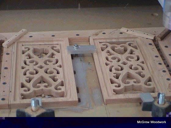

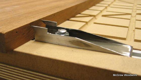

james mcgrew
lotta ways to hold something down, i got three festool clamps and drilled holes to specs, table can be put up when not in use.
great tool when needed
jim

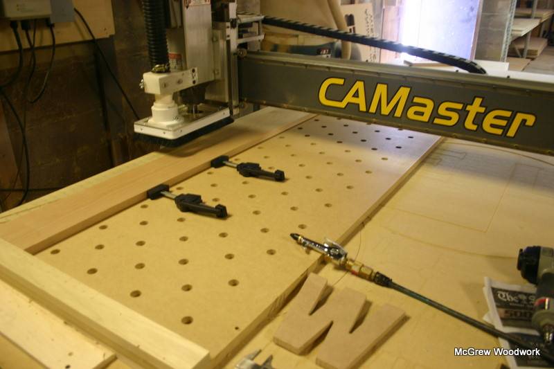

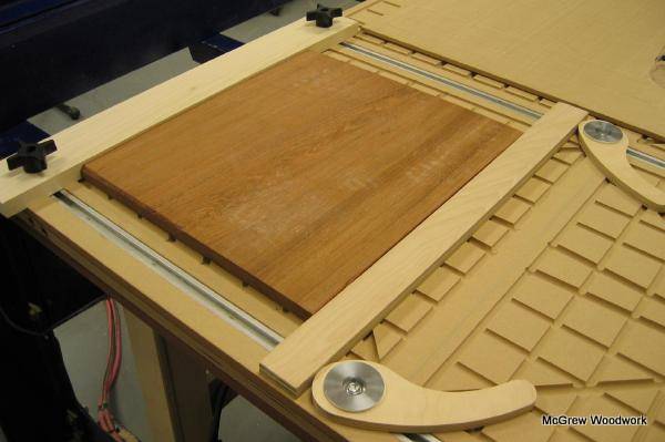

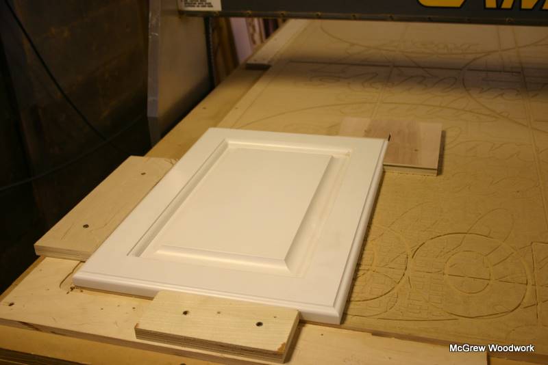

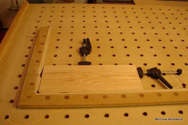

james mcgrew
multiple options
here are a few, my festool table works well and is removable when i am doing sheetgoods, i intend to build the t-track into the new machine table.
jim
